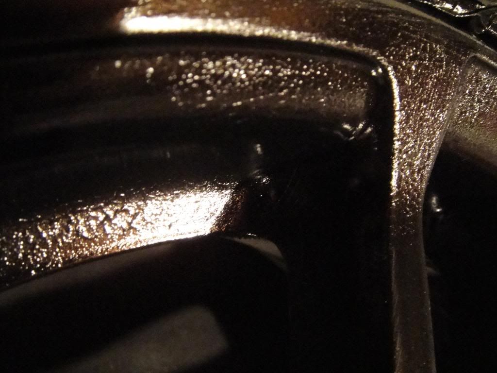

im not sure if u can see it, it caused moreless a wrinkle effect, and it was duplicolor clear for wheels, it was a brand new can and dad told me to try it, which now i regret it lol, the other wheels got shinier over night as the paint is curing, so im sanding this one down with the 320 til i getthe erinkles paint off, should i re primer, or just re black after i get it all sanded

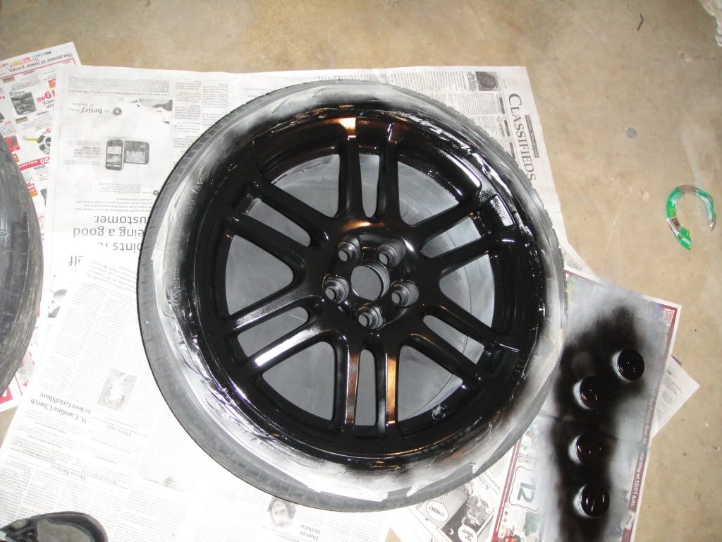

heres a pic of a wheel before the lsat coat of black, and no wrinkles

Ill say the two paints, black and clear are not compatible. ie/ enamel black and laquer clear. Most Duplicolor paint is lacquer. Wrinkling or bubbling are usually the results.
