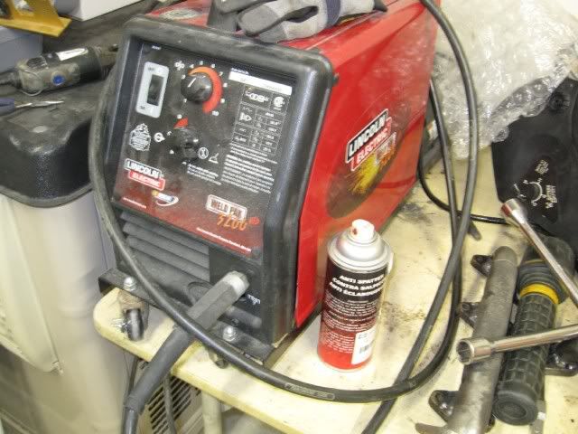

Report this Post12-09-2010 11:42 AM Click Here to See the Profile for katatakSend a Private Message to katatakDirect Link to This Post
Here's what I use - it's 110. It works great - been welding with it for about 8 years now. I use Flux cored and Gas. Fux cored works great if your material is "clean". No rust, paint, grease, etc. Using an "Anti Splatter" spray helps keep the splatter from sticking - makes it easier to clean up the weld. MIG (gas) is way more forgiving. Like said above, watch some video's, read some books and practice. I have been "recreational" welding for 20 plus years. Started out with a 220 volt Lincoln stick welder. I have good days and bad days. It's all about knowing the steel, machine, wire and being able to recognize when things go wrong. I recently picked up a "Aluminum" welding kit for my little Lincoln and will start working on some aluminum projects. For 300.00 to 400.00 you can buy a decent Lincoln wire welder at Home Depot or Lowes. Buy the best equipment you can afford! Good Luck!
Pat

my 1st welder is a 110 lincon flux core welder i got at home depot.
when i did my 1st weld on some scrap metal. it was horrible! so much splatter and it didnt even penetrate much, i got it about 2 years ago. now i can weld up exhaust systems. i gotten to know my little welder quite well. im no pro at welding. but the more you use it. the better you get!
just start out by finding scrap metal around the house or garage. or even some old exhaust pipes if you have any laying around and just weld metal chunks to them.
one good helpfull tip. always wear welding goggles or helmet. one look at the welding light. you will be seeing bright dots for awhile. i was doing a quick weld to fix an exhaust leak and i was to lazy to run back in to get my welding helmet. so i got everything ready to start the small weld. i started a split second to fast before my eyes could close. and BAM! brightest thing ever! and dumbest thing ever to do. always wear welding goggles. i also heard stories of welders closing there eyes while welding and ended up having welding tans on there eye lids.

Pick up somestrong welding magnets as well. it will make life quite a bit easier...
But I agree, an auto darkening welding helmet is a must! I just purchased the Harbor Freight helmet for $39.00 on sale; I would have paid $100 for it, I like it that much... It WILL make you a better welder...

It's all in the tune. You will not have much of a chance at a good welding bead if you don't tune the MIG unit in first.
Get a piece of scrap metal the thickness of what you'll be welding on, pick your heat setting, start your weld and adjust your speed until you hear a nice steady fizz.
I picked up a great Century unit on wheels from Sams club 15 yrs ago for the price of the Harbor Freight unit you linked to. I had a bunch of plans and no training but I could read and that was good enough.
In my opinion it was too easy to take a class on after following the tuning instructions. I used flux cored wire once and that was at the advice of a professional since I was welding on cast iron.
Get the gas and if you buy a 110v unit use .024 wire as the thicker wire tends to tax the 110 units more in my experience. Make sure it has a control knob for heat setting and wire speed. If you use an extension cord make sure it's a thicker gauge than the cord on the unit as poor current to the unit will affect your welding.
I see no problem with buying an inexpensive to moderately priced unit to start with unless you plan on using it quite a bit to justify the expense. You can always sell it and move up if necessary. The problem with the Harbor Freight models is availability of parts should you need them. If they are readily available that unit should work fine. My MIG is still going strong although it's a Century which I believe is a decent model or at least is performing like one.

Originally posted by ALJR:
HAHAHA.... Wow, your good... It was the first thing I built
1. It'll get your welder portable
2. You'll get some welding experience
