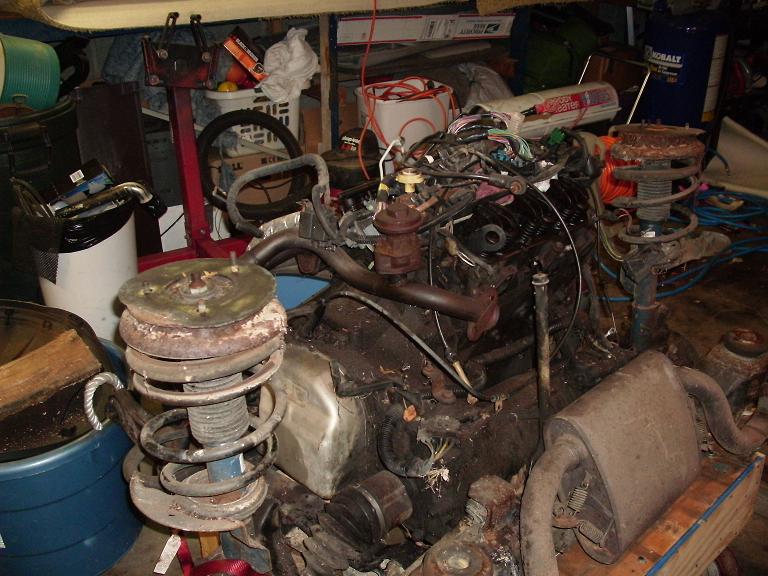

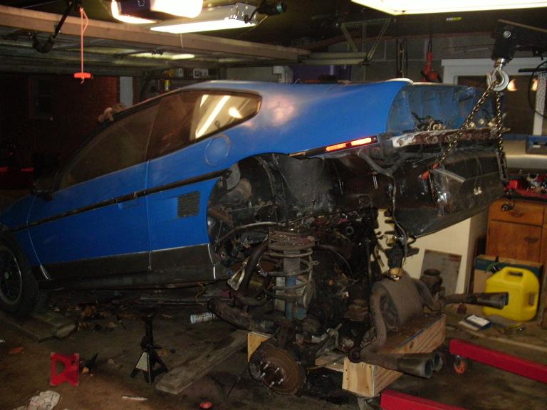

I got the engine out today. thanks to the help from every oe here and my pastor. now the fun begins.

Report this Post12-31-2010 11:52 PM Click Here to See the Profile for My04gtSend a Private Message to My04gtDirect Link to This Post
My04gt
109 posts
Member since Dec 2009
pic
