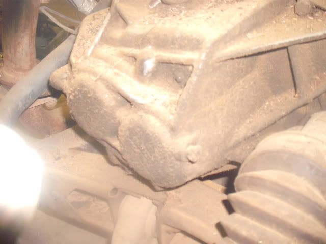

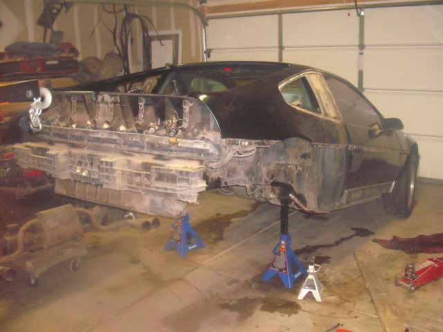

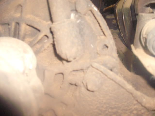

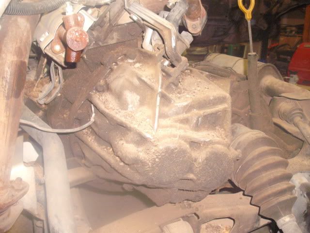

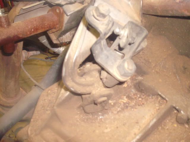

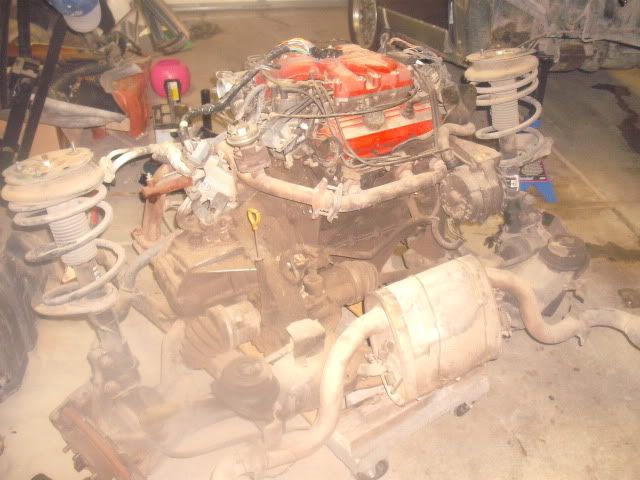

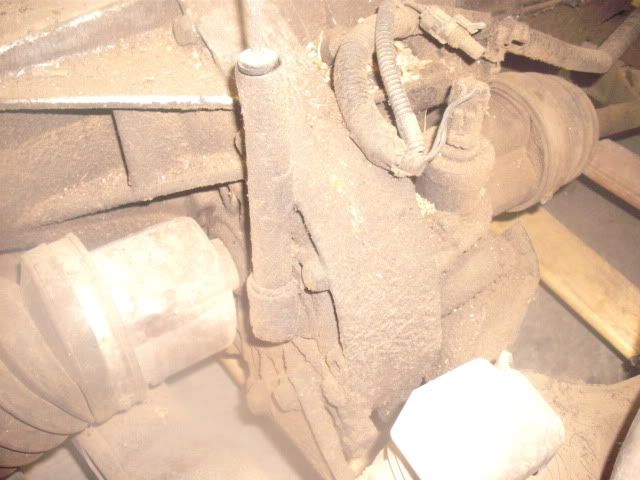

OK, here it is. Tell me what I have. I'm thinking it has the dipstick added, but I hate transmissions, and know almost zero about them. This car has been butchered up a little in the past and has been sitting for at least 3 years. (plates expired in 07). The muffler is patched and the cat deleted with a pipe. The wiring is a mess and engine partially taken apart for repairs that never were complete. Looks like someone threw a few parts at it, then gave up.
Ass in air shot.
Getting a little tight with two Fiero trailers and this pig in the garage,....

Looks like a 85-86 V6 style 4-speed. The ribbing on the case is a dead giveaway. Someone must have added the dipstick.
Bloozberry
Posts: 7760
Registered: Jan 2009
Total ratings: 311
Report this Post12-06-2010 07:20 AM Click Here to See the Profile for BloozberrySend a Private Message to BloozberryDirect Link to This Post
I agree.
