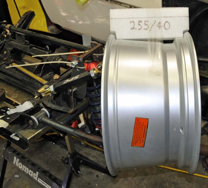

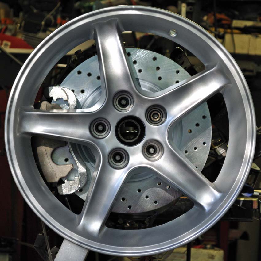

I've got 17x9 Cobra R's on my front using Saturn Vue hubs on Pontiac Solstice knuckles.
The wheels require taper seat lug nuts, so even if the adapter does not have a pilot hub surface the lug nuts will center it. But keep an eye out on your total offset, these are pretty wide wheels.

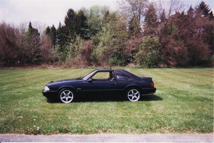

Had to post a pic of my old 5 lug conversion with Cobra Rs....
And just before the conversion...

Damn! Tony, we have twin Mustangs.
Tony Kania
Posts: 20794
From: The Inland Northwest
Registered: Dec 2008
Total ratings: 305
Report this Post12-03-2010 02:38 PM Click Here to See the Profile for Tony KaniaSend a Private Message to Tony KaniaDirect Link to This Post
Sadly, mine was stolen out of my garage in Detroit in 01. Do you have any pics of yours? Heck, do you have my stolen 'Stang?
ccfiero350
Posts: 826
From: Houston, Texas
Report this Post12-03-2010 03:03 PM Click Here to See the Profile for ccfiero350Send a Private Message to ccfiero350Direct Link to This Post
Are you sure they're 9s? Because those have been made in 8s also. Maybe you're measuring wrong? The correct way is between the tire beads, not at the widest parts of the outboard lips.
Ummm, pretty sure, I even made a mock up wheel section.
very cool! can't hurt to be sure.
