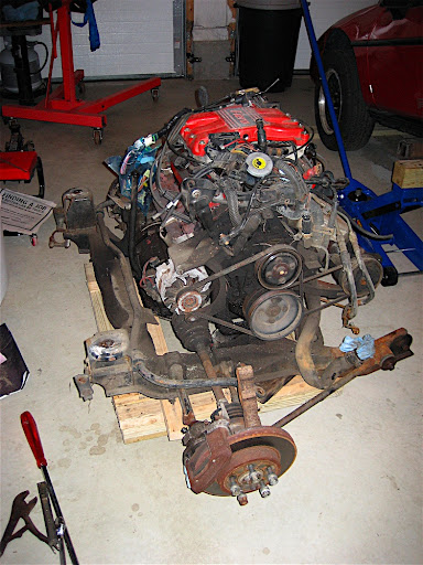

The 4 cylinder is a 2.5
The 6 cylinder is a 2.8. The six looks like this
Which is yours?

I am for sure it is a six cylinder, mine does look like that picture. I know he did swap in a new one because some of the mounts are a little different. My oil fill part is a lottle different from that picture too. And it is an automatic
