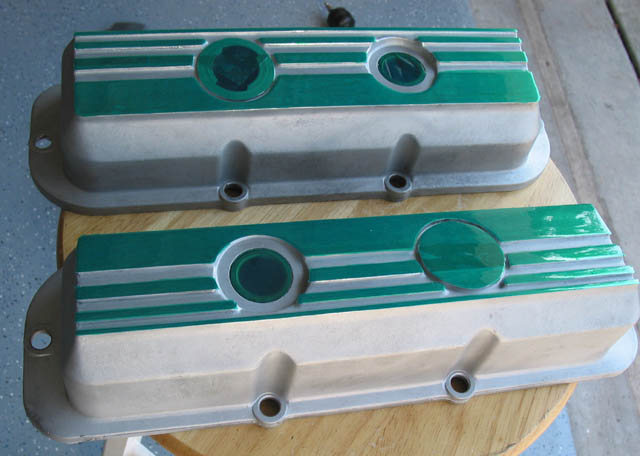

Easiest and best is to take them to a local machine shop and ask them to hot tank them. Shouldn't charge you more than $15-$20 and will look like this with 0 effort
