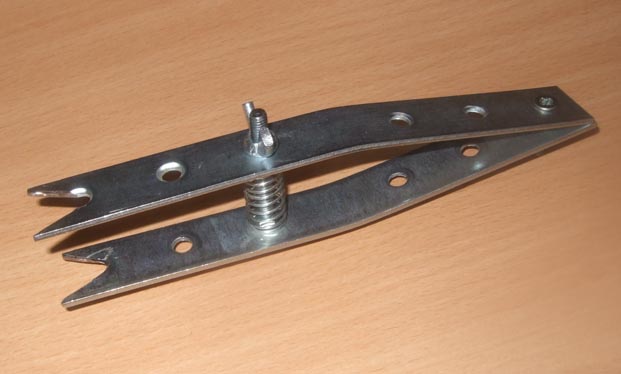

And I'll add my 2 cents. Yes there is a tool to turn the piston to screw it in. I have use these before but if the outer piston seal does not slip on the piston it can rip the seal so I tend to avoid this method.
I also remove the ebrake lever but sometimes the piston still does not push in so I use the c-clamp off to the side of the ebrake screw and alternate tightening the c-clamp and turning the ebrake adjuster so that the piston goes in.
As said, under the lever watch that you don't loose the rubber seal and plastic washer.
Also you will see four dips in the face of the piston. These have to be at a right angle to the caliper so that the dimples on the back of the pad fits into them If they are off then the pad will not seat all the way.
I don't mess with the adjuster. I just compress the spring with a door spring compressor then grab the end of the brake cable with a pliers and slip it out of the lever. The spring compressor comes in very handy when doing the brakes as well as doors.
http://www.harborfreight.co...ring-tool-95344.html
[This message has been edited by Dodgerunner (edited 10-24-2010).]
I agree 100%! The door spring compressor is the handiest Fiero brake service tool I own.

I had to use the special tool on mine after trying a c clamp. I did the job in the parking garage at my work and had to explain to the security guard what I was up to, but the job went well and I was counting on being able to use the car right away too. Good luck. It's not difficult.
[This message has been edited by dratts (edited 10-25-2010).]
