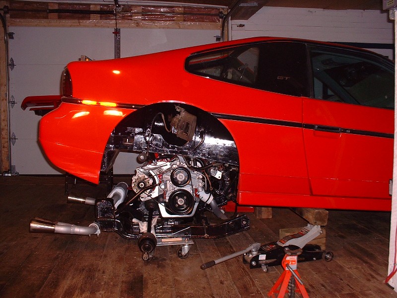

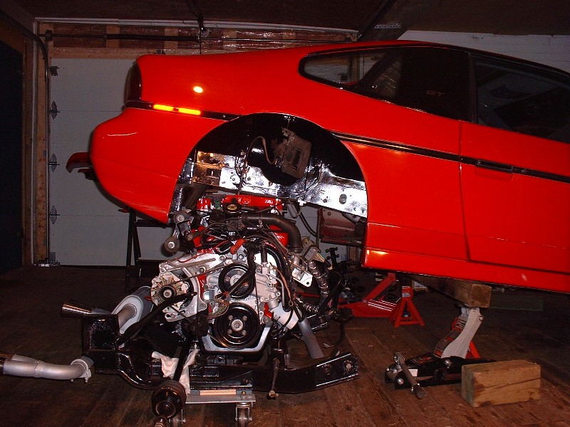

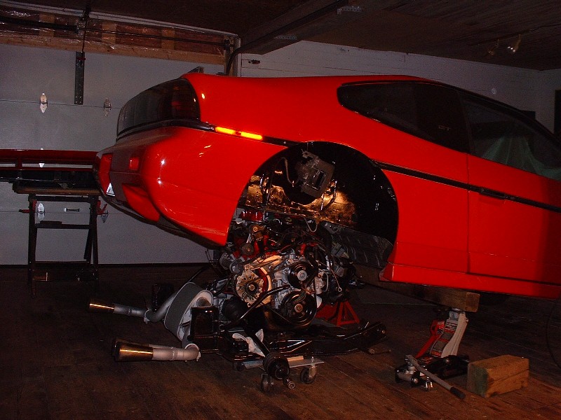

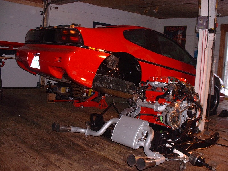

I do mine as phonedawgz says with the shock towers.
One other tip is to have the front wheels up higher on ramps or blocks so the nose clears the ground. Make a lot more room under the car. If you do though you have to be able to lift the body high enough to be able to roll the engine out since you will not be able to move the body.
I had the front bumper off in the pic so nose was not a problem but was still close to the ground.

I use a 4X4 post like garage monster, except that I use a hydraulic floor jack on each side of the car rather than in the center of the post. It's probably safer this way since you don't have to be under the car to jack it up. Once everything is disconnected except the cradle bolts, put the post under the car and support the weight of the car on the post and lower the post onto a pair of jack stands. This allows you to re-use one of the jacks to raise the cradle a little to take the pressure off the cradle bolts. That makes it easier to remove them. Once they're removed, lower the cradle a couple of inches onto some wheel skates or a low dolly. At this point the cradle will be free of the car. Using your hydraulic jacks under each side of the 4X4 post, start lifting the car up while jostling the engine cradle around a bit to make sure it clears everything. Put a level across the decklid (left to right) as you raise each side of the 4X4 post with a couple pumps at a time keeping an eye on the level. DO NOT block the front wheels as you're lifting the car since the pivotting action of the hydraulic jacks causes the car roll a few inches on its front wheels. If the car is prevented from rolling with blocks, it will fall off the post or the post will fall off the jacks once you get past the halfway point due to the stress. Always keep a pair of axle stands under the post in case one of the jacks decides to blow a seal too. If you place the jacks so they're facing towards the rear of the car, you'll have plenty of room to pull the cradle out from the wheel well without any interference. By pulling it out from the wheel housing, you don't need to lift the car anywhere near as high as you would to pull it straight back since you won't need to clear the low hanging trunk metal. Here are a couple pics that might help visualize the process:
