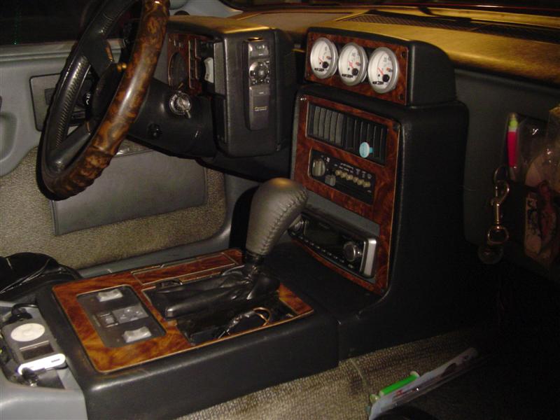

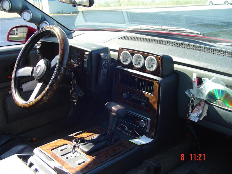

Why are you going to buy another? All you have to do decide how much you want off, Take a old towel or rag and wrap it around the shifter boot. See how far the plastic rod sticks out the top of the shifter. Take a hacksaw and cut the shifter handle off to the desired length. Cut the plastic rod so it sticks out the same length. A couple of pics
Before
After
When I originally had the automatic, I cut the auto stifter in my Indy in place as well. I just removed the shifter surround and covered the radio and center console up first. I also got a Corvette leather wrapped knob - much more compact than the stock T-handle and better looking than Cavalier/Grand AM ones. (swapped Indy over to a 5-speed last fall).
