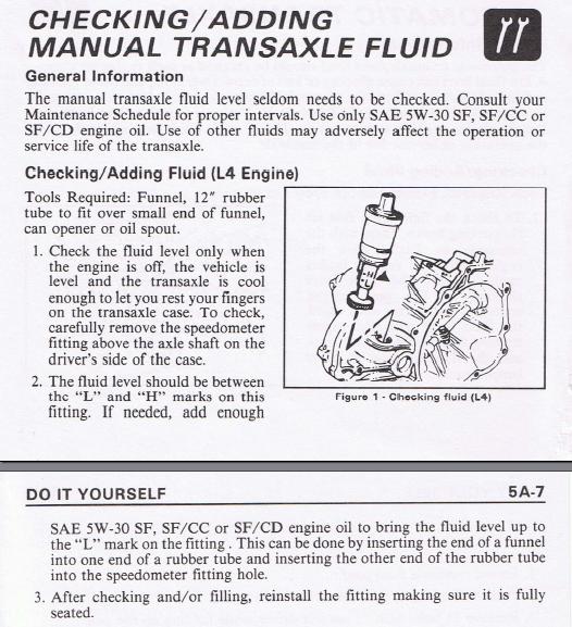

Isuzu 5 speed? Where do i fill the transmission and how much fluid should i put in?.. thanks guys.

I think... Pull VSS. Watch it! Careful you don't loose the VSS Gear.
amount oil.... See Cave.... Again....

Mine has a dipstick.

Owner's Manuals and Service Manuals http://www.fieronews.net/fusion/downloads.php
You should already have these (you've been around long enough)
Instead of 5-30 engine oil, use Synchromesh Transmission Fluid (the new recommendation) from GM, Penzoil etc.
