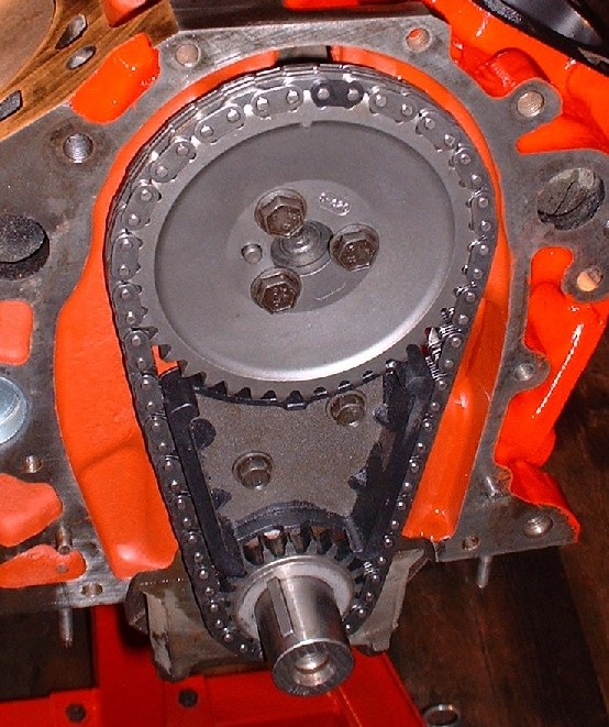

Sorry I can't tell you exactly how much slack is allowable. They get loose because of two reasons, the first is that they will stretch over time simply from the force that's exerted on them. The second reason is that the pins that the teeth on the gears mate up with will wear down out of round. The wear on each pin is almost insignificant but when you add up the wear on all of the pins together, you get some slack.
On a new installation, there isn't much more than 3/16" deflection when you push on one side of the chain. Don't forget to have a good look at the chain guide too. They're inexpensive... around $15 here in Canada. Here's how tight a brand new chain and sprocket set looks:

The left side of the chain will have some slack, the right side should be more taut.
