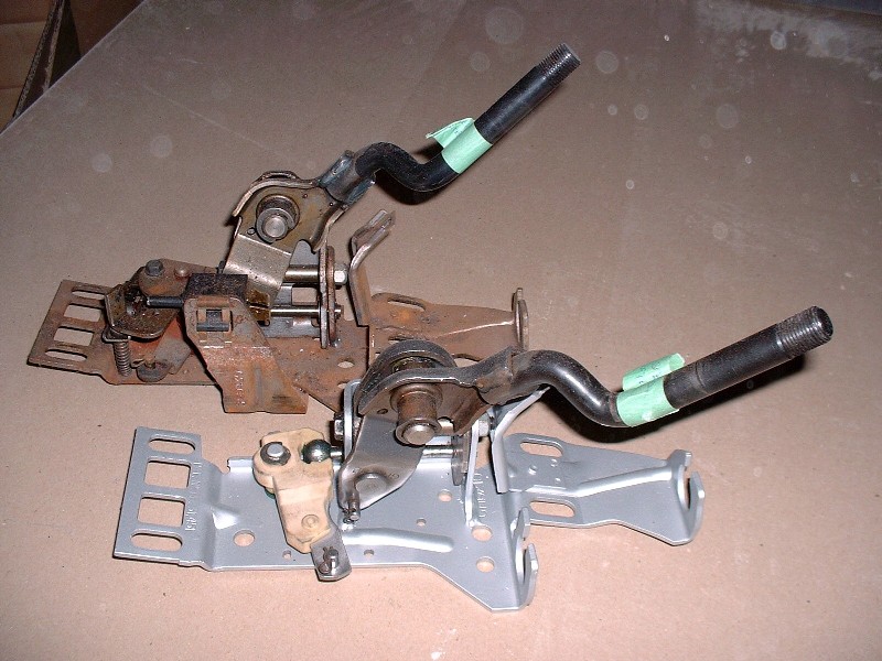

A picture is worth a thousand words... the four speed shifter is the one in the backround of this photo. The little black box near the bottom center of the shifter is the back-up switch. It has two pins for an electrical connector on it.
