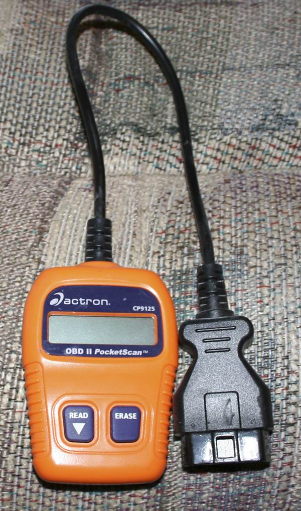

You can pick up a OBD2 code reader at your local Autozone or Advance auto for $40-$80 depending on which one you buy.
I bought this one for $50 It comes with instructions on how to use it and also a booklet telling you what the codes mean.

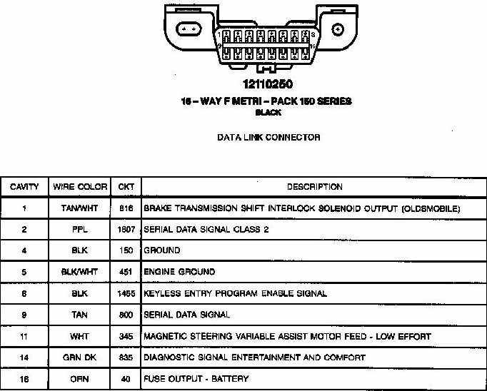

Also, I wanted to get a OBD II code reader. My connector that I pulled from the 96 Riviera is 12 pin. Is this OBDII? My understanding is they are 16 pin connectors. I dont want to purchase the wrong one.

Adding: Your donor car should have had the 16 pin connector. Did you adapt the fiero ALDL connector to your harness? According to AllData, you should have this:

Looks like I have the wrong connector...Anyone have a OBDII connector?

They sell them on eBay. As for a solid scanner/code reader. If you own a laptop you can but an OBDII interface box that comes with the software for about $35.00 or if you feel like making the investment go with HP Tuners Tuning Suite. Its a $500 investment but you can also make a variety of tuning changes. WE have both here and surprisingly the $35 scanner one works OK but you can't data log all parameters with it.

(Advance auto has a code reader on sale, like Jimmy mentioned above, for $50 till the end of the month.)

For the money this looks like the best OBD code reader. Around $50 delivered.
