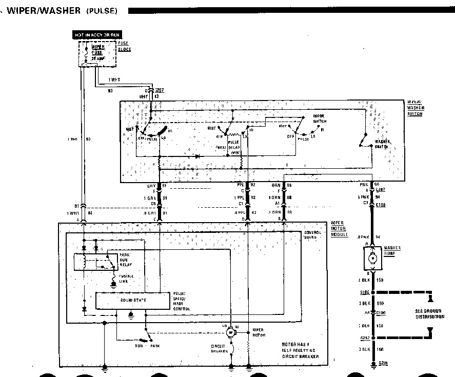

Anyone happen to know (or have a wiring diagram) of how the switch in the stalk is set up for the delay settings.

I can scan the wire diagram in for you from the '86 service manual, but I'm not sure it will help because none of the resistor values are marked nor are they mentioned in the system diagnosis. There are two fixed resistors and one variable resistor though.

If you don't mind that would be helpful at least I can verify everything else is hooked up right.

Not the greatest quality, but at least it's legible. Let me know if there's something you can't read and need to know.
