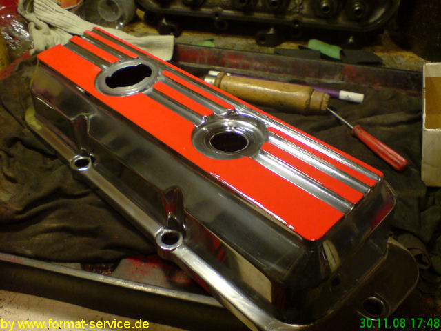

moin ,
i used brake caliper paint for the red parts and special clear painting for the polished parts .
after 16000mls it still look very good and no single heatbubble in sight.

Ah I'm not sure if anyone has let you in on this or not but you painted it backwards!
(I hosted a high school student last year who was from Hamburg)
colorscheme was intended , thought enginebay would get a little more light

Yeah actually I kinda figured that. The polished looks really nice!
