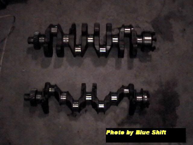

Plus the 2.5L Iron Duke (called TECH 4 in 1987) was never meant to be a high performance engine. It's an economy engine. Mine would knock like crazy using regular unleaded in the summer. I always ran premium because of it.
Here is a pic of the duke crank (bottom) compared to a mercruiser crank.
