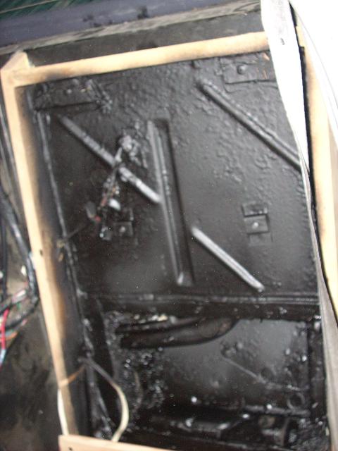

josef644
Posts: 6939
From: Dickinson, Texas USA
Registered: Nov 2006
Feedback score:    (71)
Total ratings: 103
Report this Post08-14-2010 07:44 PM Click Here to See the Profile for josef644Send a Private Message to josef644Direct Link to This Post
Here is where I am trying to repair my 88 that I didn't know the PO had butchered . That is the fuel tank hose there:
and here:
Cut and installed the other speaker hole cover today. These shots are from the engine side of the firewall:
Buy you a Walkman and turn it up full blast. Fixing this F*** Up was real fun.

Khw
Posts: 11139
From: South Weber, UT. U.S.A.
Registered: Jun 2008
Total ratings: 134
Report this Post08-14-2010 08:33 PM Click Here to See the Profile for KhwSend a Private Message to KhwDirect Link to This Post
Originally posted by jasedude:
Also, I have done a battery relocation, so perhaps the best place to go in would be through the passenger side where the battery tray is. Is that section double fire walled?
As you can see in the pictures josef644 posted the upper area of the firewall is single layer. So if you went in where the battery used to reside you'd encounter a single layer. The problem with going in there is you will be going over the belt side of the engine and I don't know if you have room to route a tube in there because of that. The lower section is double layer as a channel runs behind the firewall. This channel is sometimes opened up to allow the backside of the speaker to utilize the space for mounting depth and a little extra airspace. The problem is on the drivers side the fuel lines run through that channel and great care must be taken if you remove the part of the firewall foward of the channel. Also this channel is not sealed to the outside, so you will need to seal up each end if you went that way. Here's a picture of the channel opened up on the drivers side.
The metal of the channel extends maybe 2" above the cutout shown and from there up the firewall should be single layer.
Edit: A note on the 2 12's. I used to run 2 12's in my kingcab pickup truck. I eventually went to 2 10's for more space and was suprised that the 2 10's were louder. If you check speaker specs, you can find comparable spl ratings between them. The biggest difference is going to be in low frequency extension, but in all honest you can find 10's that can play down to 30ish hz which pushes the limit of what humans can hear anyways.
[This message has been edited by Khw (edited 08-14-2010).]
