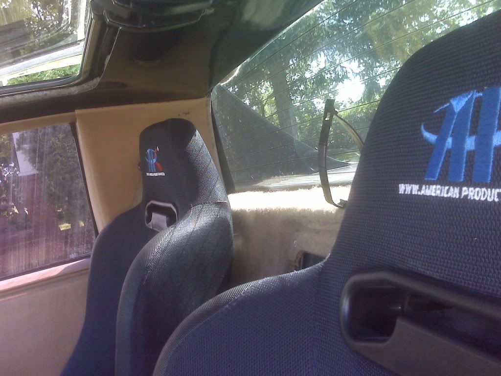

How do I remove that ledge that is behind the seats?

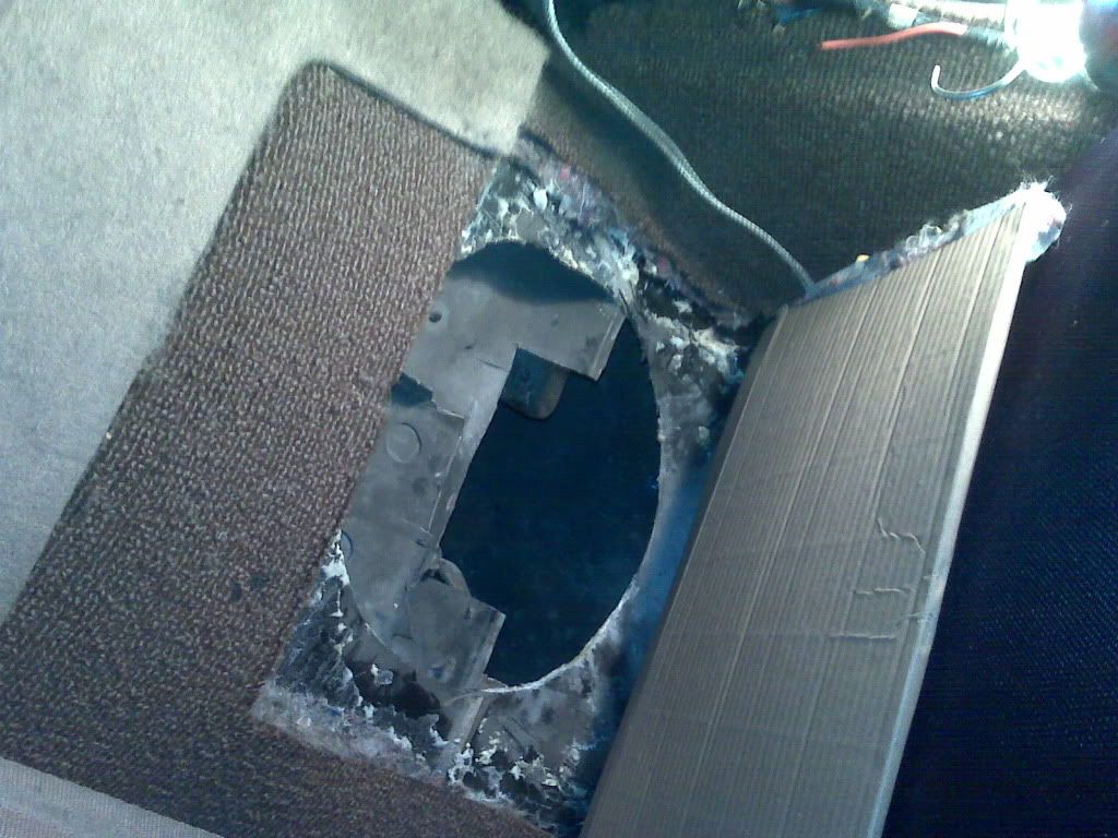

Lotsa work, probably will affect the rigidity of the spaceframe, why would you want to?
I want it down to just the metal there. need to do some welding and cutting in that area. He said to come back when all fire hazards are removed from the area.
Now
Soon to be
We need to repair the previous owners mistakes and cut out the rest of the support channel.

Mine had 9" holes cut into the metal there. I used pop rivets to attach metal back in there. No welding required. I put a sealer, black trim adhesive, on the metal before mounting it all up. I also put a bit over each rivet end to prevent any leaks. Then remounted the firewall cover.
Just sitting there not mounted yet
installed
finished up

The holes are welded, did a decent job too if you ask me, but i'm no professional.

josef644, his holes are in the lower area where the second firewall is. What you posted has them higher up on the firewall where it's only a single layer.

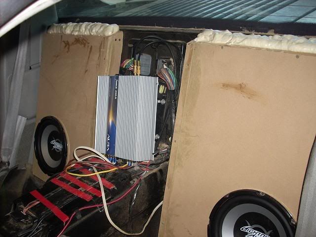

You can see here where I cut the front firewall out but the rear is still intact. The OP's car, the previous owner cut through both firewalls. I suspect he is having the rear firewall repaired.

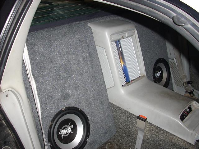

Here's a pic of how the enclosures the OP showed during construction turned out. I still need to do a little more work to the amp mount. There is a few things I'm not happy with, but it will be fixed in time.
[This message has been edited by Khw (edited 07-31-2010).]

Originally posted by Khw:There is a few things I'm not happy with, but it will be fixed in time.
What exactly are those things so that I may try and avoid them.
Khw
Posts: 11139
From: South Weber, UT. U.S.A.
Registered: Jun 2008
Total ratings: 134
Report this Post08-01-2010 10:57 AM Click Here to See the Profile for KhwSend a Private Message to KhwDirect Link to This Post
Oh, the things I'm not happy with was how the amp mounted to the console. It wasn't very sturdy. I have since mounted a piece of wood in front of the ECM and mounted the amp to the wood, I just need to get it centered up a bit better. I also want to clean that part up some, maybe some carpeting on the wood, or textured fleck paint. Use some spray foam to fill in the gaps around the amp a little more shape it and recover the console. The woofer enclosures, I love the way they came out. It's just the amp part I want to do a little more work on.
yes, this is where most cut into the firewall for extra space.
and - this also shows one of the major "fire hazards" - the fuel fill hoses.
not just a fire hazrds - but a explosion hazard
Yeah that's why I took a picture of the drivers side. Specifically to show the fuel lines so others that do it will be as careful as I was to not hit them.
