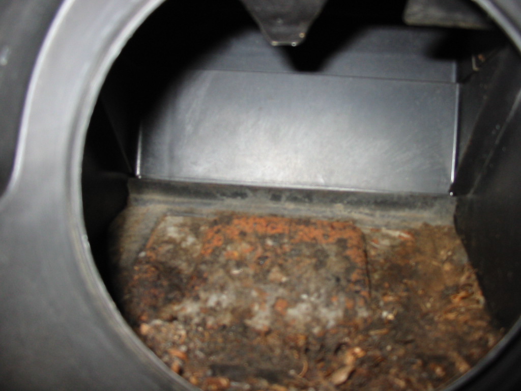

2farnorth
Posts: 3402
From: Leonard, Tx. USA
Registered: Feb 2001
Total ratings: 81
Report this Post07-20-2010 07:36 PM Click Here to See the Profile for 2farnorthSend a Private Message to 2farnorthDirect Link to This Post
When you take the resistor pack out you may find something like this.
I pulled the entire "squirrel" cage and motor out. Found it had been used as a mouse toilet! Scrubbed with a disinfectant, then had to use a small wire brush on a Dremel to clean the crud off the floor of the duct. (Use a face mask.) Had to put gloves on and reach back in the duct to get the remains of the nest out. (along with a couple little skeletons)

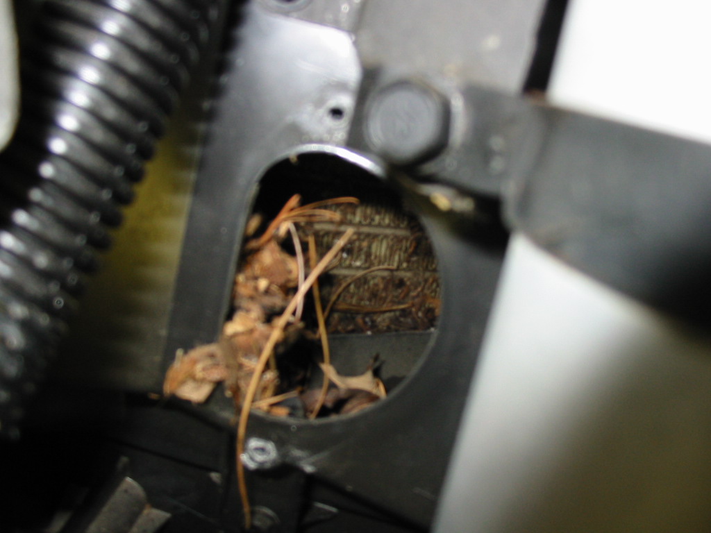

Report this Post07-20-2010 08:10 PM Click Here to See the Profile for 30+mpgSend a Private Message to 30+mpgDirect Link to This Post
Using a coat hanger
An inside shot before vacuuming
After vacuuming
That should yield a minor improvement in airflow.
