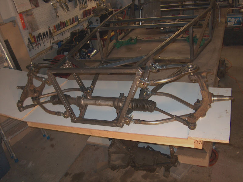

I have a Chevette power steering rack mounted on my Fiero crossmember. Here is a link so you can see what is needed. This is not my build.
http://diablo.kitcarmagazin...or/PowerSteering.asp
Mike
Mike
The method used there would be unacceptable to most people as it would likely significantly affect bump steer. The extensions to the rack need to be INSIDE of the inner rods, i.e. an extension to the rack itself. Otherwise the tie rods pivot at the wrong point relative to the compression of the suspension
