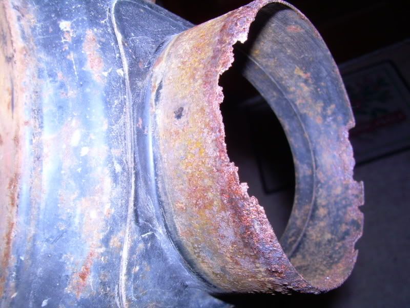

Well, I'll swap the tachs out tonight then. I don't know where my multimeter went so I'll have to pick up another and see what I can figure out. The trouble is that the problem goes away and the car can start again faster than I can take the dizzy apart and set up a multimeter
Anyway, here is what the old air canister looked like. Lots of rust and a rather large hole on the bottom of the lip that I never noticed. I wonder if thats been the cause of my intermittent code 44? Hmmm...

The MAT that was in the original can was an aftermarket replacement. The original had been chewed up by mice. The one in the current can was OEM. It wouldn't surprise me that the aftermarket MAT was crap compared to the OEM. I think the AM MAT came from O'reilly as I generally have better luck with their stuff vs. Autozone.
