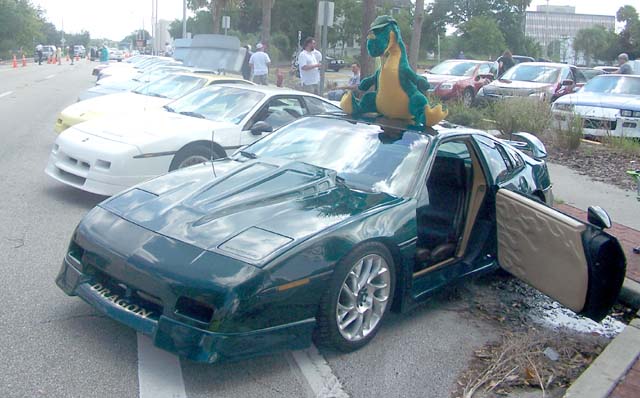

Report this Post07-06-2010 01:47 PM Click Here to See the Profile for BlacktreeClick Here to visit Blacktree's HomePageSend a Private Message to BlacktreeDirect Link to This Post
Actually, gull-wing doors on a Fiero have been done.

UCFieroCharger
Posts: 976
From: Cincinnati, OH
Registered: Nov 2005
Report this Post07-12-2010 06:07 AM Click Here to See the Profile for UCFieroChargerSend a Private Message to UCFieroChargerDirect Link to This Post
Not likely to be enough room under the car, but would still be cool:
