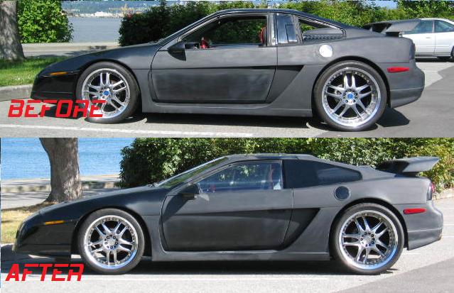

This was in fact a diy. But thats the way he cut his down and this is how it turned out-
Simply amazing.
