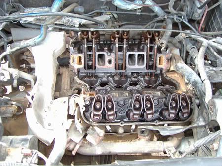

Just to let you know, the full intake gasket set costs about $22. How much are they going to charge you to change it?
Here is a pic with the lower intake removed. Notice the bottom part of the gasket goes over the pushrods and top part goes behind them? Make sure your mechanic does not cut the gasket to accomplish this. Make sure he removes the pushrods, places the gaskets, and then replaces the pushrods (in their original order) and sets the lash correctly. It's very easy to cut corners if the owner doesn't know any better.
[This message has been edited by Hudini (edited 06-08-2010).]

Unfortunately I've had my intakes off far too many times. A couple leaks plus an experiment with a home made intake. It's not hard at all. You need some basic tools like metric sockets and wrenches. A small torque wrench is very helpful too as the intake bolts are 19 lb/ft which can be easily over-torqued.
The top chrome intake bolts are 12 point 10mm bolts. Most sockets are 6 point so that one is a little weird.
I use a 5/8" flare wrench and 17mm open end wrench on the fuel lines after soaking with PB Blaster. Not sure why the inches and millimeters are mixed here, might be I'm using the wrong sizes but it works for me.
Take pictures in case you forget where hoses are routed. Don't leave anything to chance. Go slow and use the right tool. I'd recommend a Haynes or Chiltons manual too.
