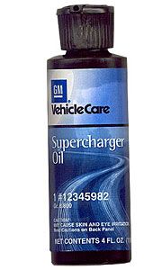

Hudini
Posts: 9030
From: Tennessee
Registered: Feb 2006
Total ratings: 165
Report this Post05-28-2010 09:19 PM Click Here to See the Profile for HudiniSend a Private Message to HudiniDirect Link to This Post
This?
