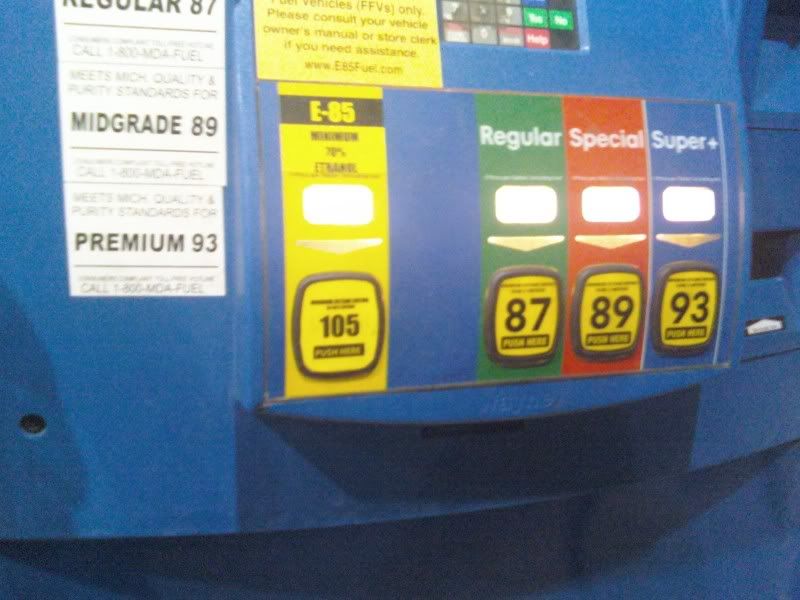

I just start with the 105 octane stuff
Turbo 3800 E85 5spd spec3
11.74@123

I agree with the simplicity of tuning; it's just a linear scaling of the pulse widths.
The bigger issue is...
I have NEVER, EVER seen a pump with E85.
Then again, I'm not very well traveled, but in the last two years I've visited New York state and Maine, and I live in Quebec.
Toluene on the other hand...
