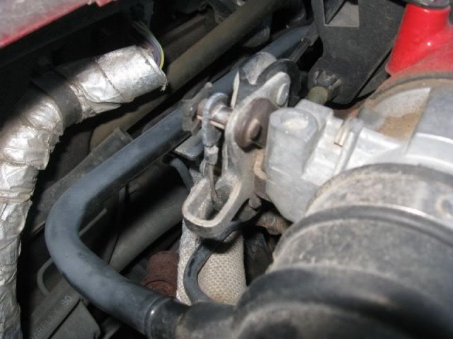

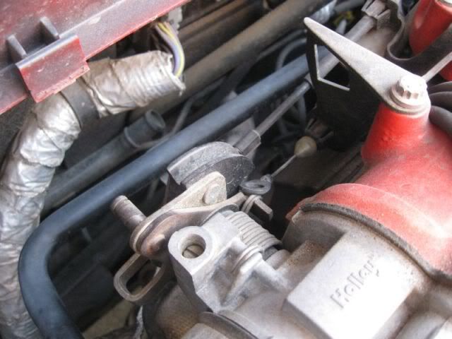

Today I finally pulled my car out of the garage for a maiden voyage. It did ok for a first trip but, it seems like my throttle cable is kind of flaky. Its like it has slack in the cable before it actually starts turning the throttle body mechanism. It is currently connected to the bracket in the intake plenum and the cable looks like it should just go over the pin on the throttle body with a clip which is how I have it now. I can stand beside the car and work the throttle but it is loose before it starts pulling????? Another thing that is not right is it incredibly hard to get in reverse. I have no idea how to adjust this if its just a cable adjustment. When I pulled the cables off the trans I marked the linkage so I could put it back in the same spot. I have no idea if the PO had the same problem. All other gears seem just fine. Any help is appreciated. Thanks

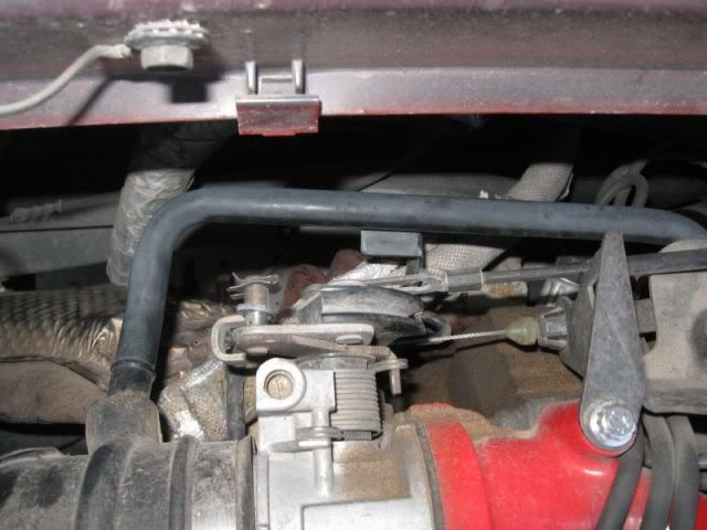

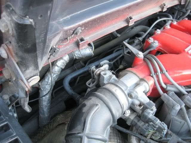

Does this help?
Cable comes from under the shaft and up through the hoop and slides onto the pin with a clip to hold it in place.
Make sure that the cable is riding in the groove on the plastic cable guide!

LOL Pat, your throttle cable isn't hooked up in this picture.

Well that looks the same as mine I think.
Second is kind of blurry but that is the bottom pin on the throttle body linkage.
Look right to you cuz I can't understand how it has the slack in the cable unless its stratched or something?? I noticed my cable looks different than yours too. More like the criuse cable in your pic. My car doesnt have cruise.

Something on yours does not look right - 1st pic looks like the cable is not seated or centered in the groove. The other is that the cable goes on the top pin! That could be why you have slack. I'll go take a pic of one that is working. I just noticed that the pic I posted is disconnected.....Thanks Hulki for pointing out my short comings......LMAO at that one.....!

I just saw Hulki's post and realized that your cable isn't hooked up. I thought the one on the bottom was the throttle and thats where I have my cable mounted is this not right.

Here you go!

Thanks Pat & Hulki. Works much better now! All that stuff was disconnected when I got the car so I guessed (wrong I might add). Plusses for both of you. Any idea on the reverse problem too?
