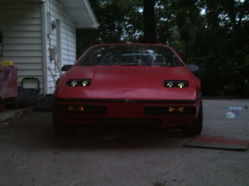

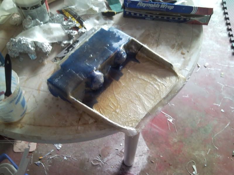

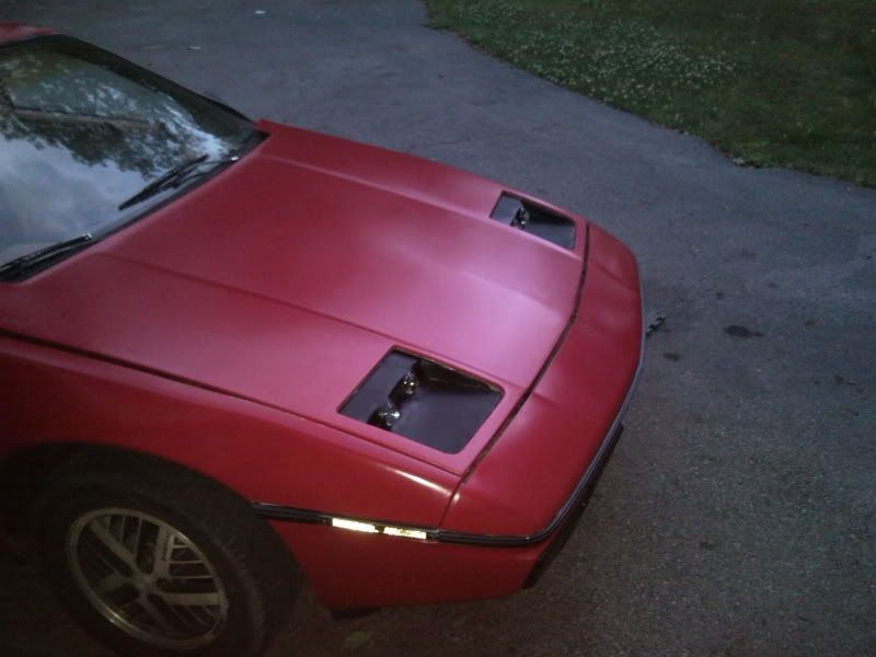

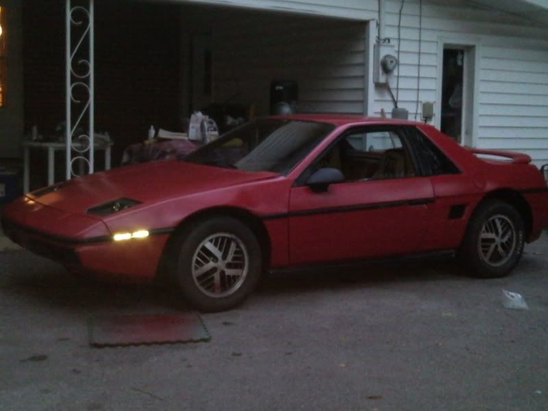

Heres the thing, i will soon be putting non pop up flush mount headlights on my car because im tired of going through motorized ones, and then getting new ones and they don't work or just other crap in that category. But i will be using the flush mount design just a different design on the inside of the headlight itself. i live within 40 miles of a junk yard that you can get body parts at for cheap. And i personally like the modern style lights on cars these days and there they have tons of cars with modern style lights. But when you buy flush mount fiero lights, the rectangle ones just don't look that great in my opinion. I like what the call "halo" lights but i just with you could find ones that were for a fiero. So heres the solution i will be going to that junkyard and getting lights off their cars and bringing them home and chopping them up. and mounting them into a flush mount fiero headlight design. And after they are nice and secured where they don't move i will fiberglass around them and give them a sleek design like in the one below.
But after i finish mine i would like to sell similar ones to the fiero community here on pennocks. Note- over the headlights will be crystal clear lexan covers.
