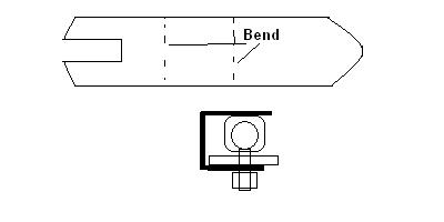

I just take a flat piece of metal about an 1.25" wide. Cut a slot in one end wide enough for the threaded stud of the ball to fit in.
Then bend it in a U that will fit on the bottom of the transmission arm and on the top of the cable end.
Take the nut loose on the stud and slip it on and tighten back up.
Put it on the arm in a position that does not interfere with the movement.

Dodgerunner that is a nice prototype you have there. I think though, that it should have a complete wrap around instead of being a "U" shape when installed. If it were a squared "O" you could easily just slide it over and have a hole for the stud to go through. That would be very slick.
As it is, I ordered Rodney's before I saw your post, but, it occurs to me that the fix you propose could be easily mass produced and would work both ball sizes equally well.

I had the same issue. the ball would keep popping out. I used Rodneys Fix. it worked well. but I always worried I would bust the remaining plastic shell with a hard shift. never actually happened. I really like the epoxy fill idea. above. I had also thought about making a clip, just as Dodgerunner described.
