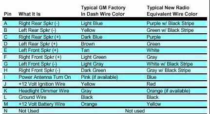

Wires are the same color as shown in my 87 Shop Manual.
LF - grey/tan
RF - green/light green
LR - Brown/yellow
RR - Blue/light blue
Shop manual gives no polarity except for the sub-woofer. Original stock speakers are labeled "A" and "B". Sub-woofer "B" is positive, "A" is negative.
Thanks.

I beleve this is what your talking about.If you have a multi meeter you can test each speaker wire,one at a time,to see which one is the + and will have a very low current (unless your running an amp,then it would be higher.The radio must be on to do this test).

Originally posted by James Bond 007:
Thanks
Not so fast, your info was wrong. I had to change you to a negative. J/K, I had thought I had you at a positive already, not even sure why I checked. You keep your positive, .
But, I need more information.
Which I assumed when I looked at the right front speaker wires. The right rear wires are red and black. The left front speaker wires are gray and tan like my 87 Shop Manual says but the left rear I still have to expose. Which I will at first light. I would rather put the passenger side back together first though.

Ignore the speaker wire color for now,because someone could have easley changed or extended the speaker wireing and this could result in a diffrent color combination,unless the person found an exact wire match (probubley unlikley).A multimeeter costs about $6 (sometimes less).I would manualley test each speaker wire, one at a time,not in pairs (ground would have a zero reading) or you can trace each wire + and -- from the radio and take note of what color wire the + or -- attaches to.
