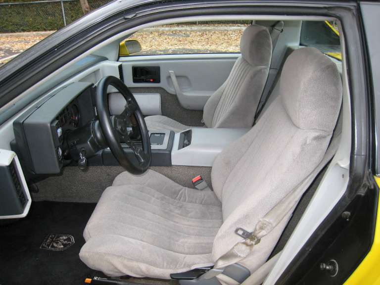

Grant GT 14" steering wheel, from my 99 Saturn which now rests peacefully in a junkyard somewhere.
Fierostore floor mats & seat covers. The fit of the seat covers is good for seat covers, but still objectionable.

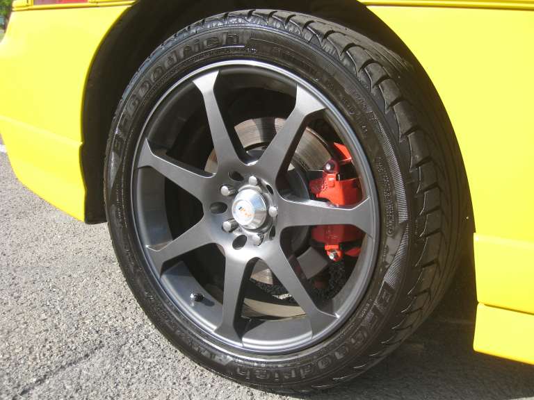

Just got some new rubber: BF Goodrich g-force sport
205/50ZR17 front
225/45ZR17 rear
The sizes aren't ideal, but it's a good compromise for the money. With this setup I'm still able to keep using my cheap run-of-the-mill 17x7 ET40 wheels, while having some stagger.
Ultimate grip isn't spectacular, but I am very satisfied with the breakaway characteristics of these tires. These tires lose traction gradually, making brake modulation a breeze (note that I have a brake upgrade) compared to the old crappy Kumho Ecsta 711s I had. Can't complain, for the price.

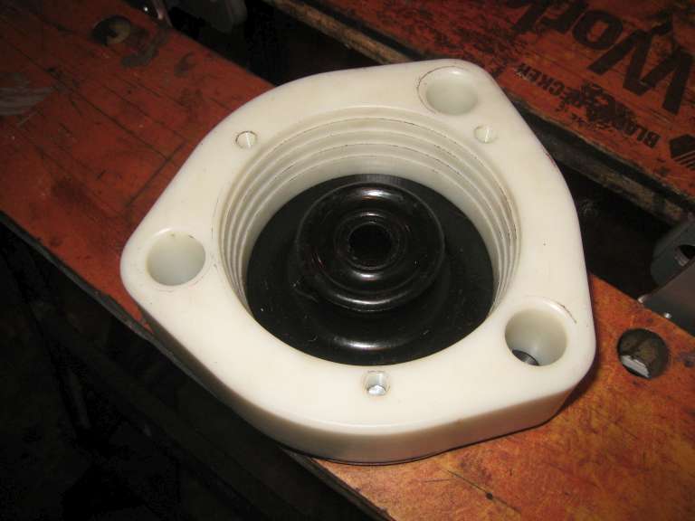

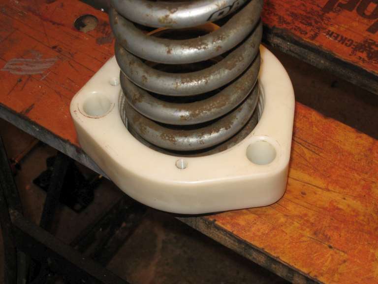

HDPE CNC milled upper spring locator. It's thick enough such that at full droop, the spring remains captive in the locator. The "tapered" sides are to accommodate for changes in the strut's angle without rubbing (due to the ball joint which moves in an arc).
Seen with spring in it, there's maybe 0.5 mm of radial play, so it's a decent fit. The spring is 12" long, and 300 lbf / in. Corrosion is merely cosmetic.

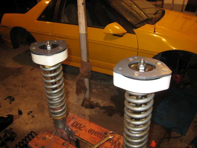

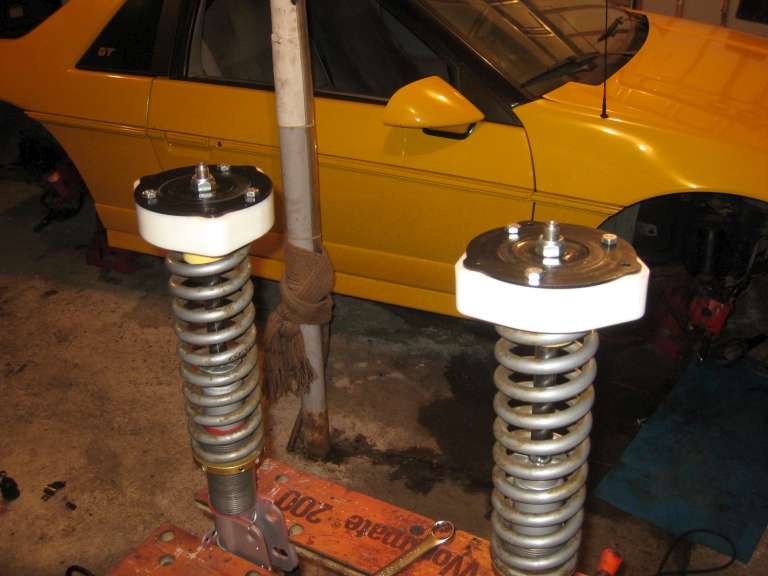

The dampers are KYB, with the perches cut off, and paint to protect the bare metal from corrosion. I trimmed down the factory bumpstops slightly to allow for more travel.
Assembled:
I added a 1/4" thick spacer on top of the strut mounts because of the spring locator bolt heads which protrude.
