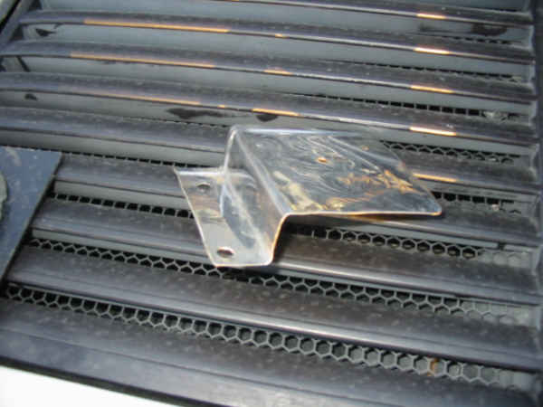

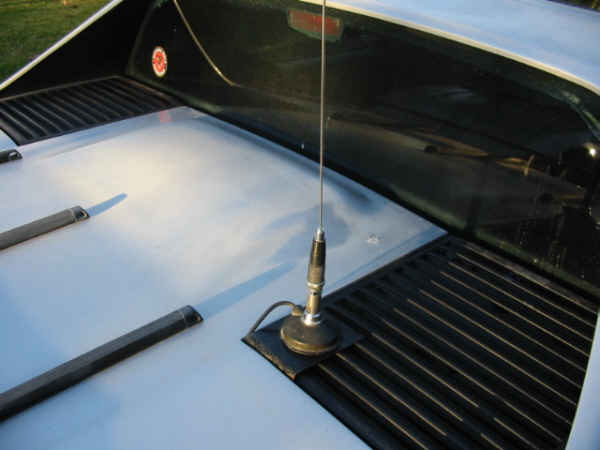

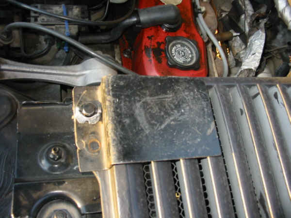

If your willing to work with a mag mount I found that this works well. This does not show the ground wire running from the plate down to the body. It's basically heavy sheet metal bent to form to the rear side of the engine vent.
The third pic shows one that I made with lighter metal. It does flex a bit with larger antennas.
The only time I carried anything bigger than a hand held in a Fiero I made a bracket that hooked into the ash tray on the passenger side and let the radio hang over the passenger side of the console with the controls facing up.
Dave, N5PNZ
