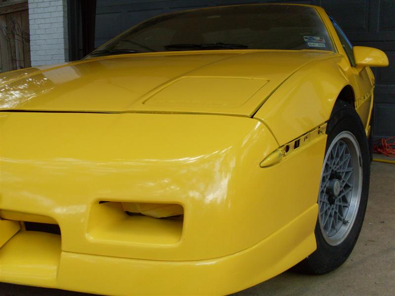

Just started painting my 86GT in Rustoleum Sunburst Yellow a few days ago. I did go to 3 shops ranging from cheapo to high dollar and included one of the major paint chains. I wanted a color change from red to yellow. Car is for my boys and I. With regards to the 199.00, it would have remained red with no primer and no real prep. You know how long that would have lasted. Yes, I had prepped it myself but the 199 included no primer. The major retail chain wanted 500 for the paint and primer, another 175.00 for sanding, 125 per door jam and another fee for hood and trunk lips. Do the math! They would not paint the car if I did the primer coat even if I used the primer they were using. How can you make sure your bodywork and prep are ready to go without primering it yourself. We do not need to discuss the high end shop's price.
I have not sprayed a car but am real familiar with the technique through years of using an airbrush. My family would kill me if I stunk the house up with auto paint fumes and it would no matter what type of booth you did unless you had a fresh air ventilation system for the garage. Neighbors would kill me if I did it in my driveway and rightfully so.
Point being in all of this is that I am on my 3rd coat and it looks freakin' fantastic. So what if it fades in a year, it's so easy you can just roll a new coat. Not to mention, using car covers, wax or a garage to put the car in to minimize sun and element damage. I have had fun, my kids have had fun helping and when we do get it finished, it will look much better then anything I could have gotten on the cheap. Look at some of the other forums; including the MOPAR forum where this all started. There are plenty of pictures of cars that have 2-3 year old rustoleum paint jobs and still look good.
If you have the $$$, pay for a nice paint job, if you have the skills, tools and proper space, spray it yourself. If you do not have either of the above or do not want to pay someone huge dollars, this is a viable and fun family project for a car that when done properly and maintained afterwards will look great. Plus, you did it yourself!
Just my thoughts for what they are worth )

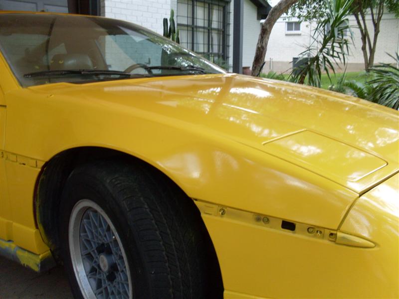

OK, that was an interesting process. Here she is after 7 coats. I plan on doing a total of 10 and if all goes well, will have it done by Sunday.
Still cannot believe how good this car is starting to look. I now have 2 friends that thought I was crazy doing this and they both plan on doing theie's this way as well!

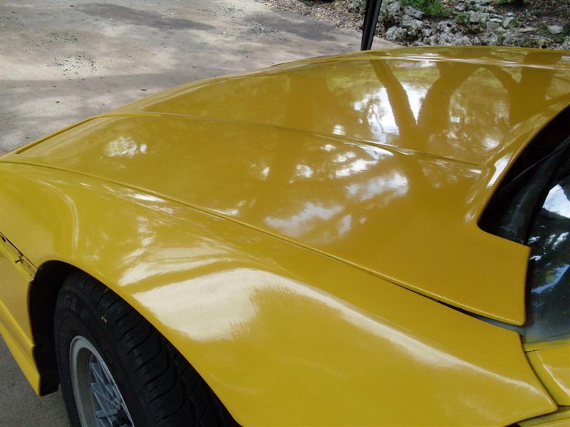

One more....
