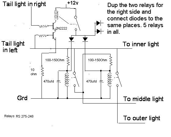

I was just playing one time and drew this up. By adding one more relay, couple of transistors and a few diodes it adds an "AND" circuit that would turn all of them on at the same time to the normal relay seq. board.
When both side brake lights have power it closes the top relay and turns on all four seq. relays through the isolation diodes.
Oops your right Lambo in fact the they would act kind of strange. For a normal stop with no turn signal they would all turn on at the same time an normal. But I think if you where braking with a turn on the side that is flashing would blink kind of wierd since all three blubs would turn on and off at about the same time.
[This message has been edited by Dodgerunner (edited 08-06-2009).]
Dodgerunner, I have thought about this in the past to see if there was an easy way to make the brake lights work like factory, with the sequencing turn signal. I got a headache and quit.
I see how the brakes would all come on at once. But if I am looking at your diagram right, it looks like you will lose the sequencing, anytime you have the brakes on, and return to sequencing, when brakes are off. I guees after looking some more, I'm not sure how the right side would sequence at all.

hey a picture speaks a thousand words for some....i tired to install this set up last night ansd got nowhere and now have to tail lights. anyone have a step by step on a fiero installation? and whats needed? i have a two module system from webelectric.
