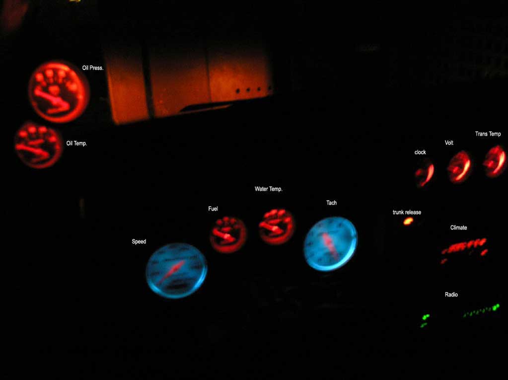

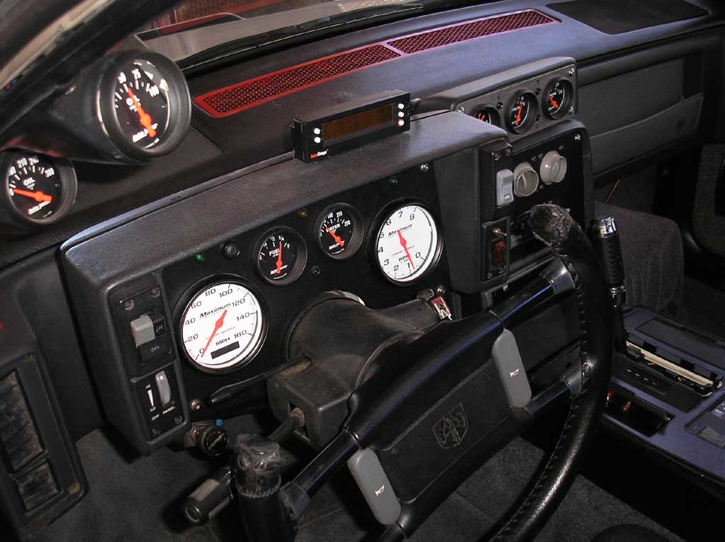

Old pictures, but pretty close to finished product.
Autometer Z-series 2-1/16 & Stewart Warner Maximum Performance speedometer and tachometer (programmable).
LED indicator lights

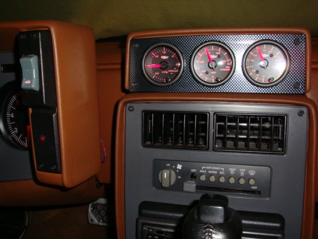

Here's what I did to my Mera.
I decided to go with the aluminum 3-hole plate that always on sale on e-bay. I liked it since its 1/4" thick...that allowed for the mounting screw holes to be countersunk so you can use the stock screws. I went with the Glow Shift due to price, but I do not like them and as soon as I build up my Fun Funds, I plan to change them out with more standard Autometer gauges.
Here's what they look like during the day, set on red (I think there's like 7 colors you can change it to).

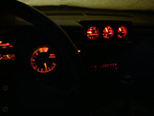

Here's what they look like at night. Real close to the stock gauges....perhaps the ONLY thing nice about this brand.
The reasons I don't like the Glow Shift:
1. In order to maintain the chosen color once set (when the engine is off), the current draw is very high. If you go to the Glow Shift website, there's a forum with some explanations on it. If you don't drive your car every day (like my Mera), the current is high enough to drain your battery within a few days or a week. I took the suggestion off the Glow Shift forum and soldered the constant hot wires to the key-on hot wire. That means everytime I kill the engine and then re-start it, I have to reset each gauge to red, or whatever color I want it.
2. The gauges fit but are pretty long, so the mounting bracket will not clear the inside area of the gauge housing. I ended up having to cut each gauge bracket in half, and just use one of them on the top of each gauge in the back of the plate.
3. The Glow Shift gauges have a curved, plastic lens. You get what you pay for. They are really made to have the gauge aimed directly back at the driver's head. When mounted straight-on in the aux gauge housing, the view is slightly distorted/obscured from the driver's seat. For me to get an accurate view of the gauges, I have to literally shift my body and head towards the center console. Even old-school S-W gauges would perhaps be better.
All in all, I would recommend the 3-hole aluminum plate advertised on e-bay. Its precision CNC cut, and the countersunk screw holes are very nice. I would NOT recommend Glow Shift gauges, unless perhaps being mounted in the pillar where they will be aimed directly back at the driver's head. But even then, you need to watch for that current draw.

thats a good review to go off of. thanks. i read some reviews on the prosport gauges, said not to be that accurate. that one person went through 3 boost gauges due to inaccuracy. enough for me to not be interested in them anymore. it sucks cause those autometers are pretty pricey. but at least we know their quality.

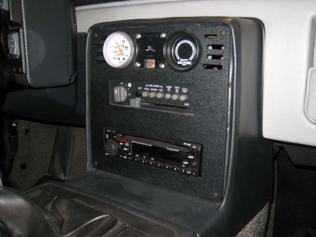

I have an autometer boost gauge, and air/fuel mixture gauge. In between them, there is a radiator fan switch, and a low washer reservoir warning lamp.
This is all mounted on a piece of 1/4" PVC plastic which replaces the stock piece, painted black Krylon wrinkle paint. The other faux aluminium interior parts were painted black wrinkle to match.
I don't have any experience with glowshifts, but my autometer boost gauge reads about a psi too high, which is no big deal anyway, as a gauge is more useful to observe trends, than to know an exact value.

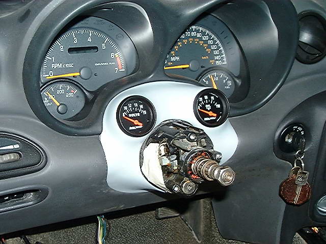

Not on a stock setup, but here are my volt and oil pressure gauges.

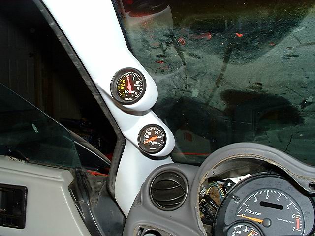

And my boost and trans temp gauges.
