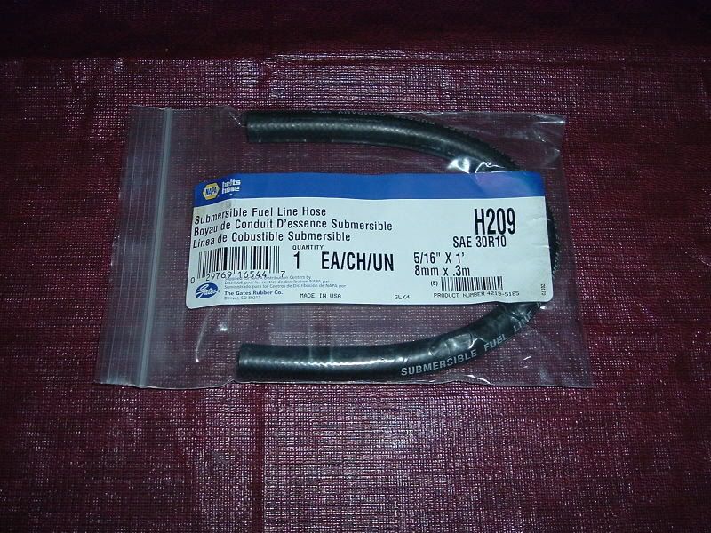

Sometimes I love this forum.... I've been having problems with my 255 pump.. It is the Walbro, made in the "U.S.A" F20000169. I purchased it from the Fierostore. It seems to be cutting out or the pulsator is leaking on the out line from the pump.... I get no noise sound except from the key in the on position to pressurize the fuel lines. But the pulsator is supposed to eliminate the sound. That's its purpose I read somewhere...
Did any of you put the pulsator back on the pump when you installed it or did you use the hose instead?
I like to say thanks to Dennis and Dave for those key points... I just went to PepBoys and bought a foot of J30R7. As they said that it was good for it. I'll go to NAPA tomorrow. Good call!
The wire used.. how do you tell if it's safe for being submerged in fuel? Where do you get those? It's a very good possibility that it's not conducting correctly for ground or power in mine. But in testing the G pin the first time I was having problem and it ran the pump fine for 6-7 minutes. This was a couple months ago... and I didn't drop the tank. just changed the fuel filter.
For a freak reason, I guess, the car was burning up the road "GREAT" but now it's doing the same exact thing. I didn't run the G pin this time... Just dropped the tank to investigate.
Since I have the tank out I want to make sure I eliminate all the possibilities. You know how much a hassle it is to drop the tank.

I have the Holley 12-903 fuel pump rated at 255 ltr.
I installed it with submersible fuel line and found it to be noisy and annoying with my 3800 swap. When I did my second engine swap, a N*, I installed another new Holley 12-903 fuel pump. But this time i bought a new pulsater and a thick Walbro fuel pump sleeve. Both made a big difference in lowering the sound to where I don't think about it in the car anymore. I think that the pulsater helps to stop the vibration from the fuel pump to the steel fuel line and the sleeve keeps the radiating noise from traveling outward with the closed cell foam.
I plan to do all my pumps this way in the future now that I'm happy with the results.
I purchased the fuel pump sleeve on ebay: http://cgi.ebay.com/ebaymot...fPartsQ5fAccessories
