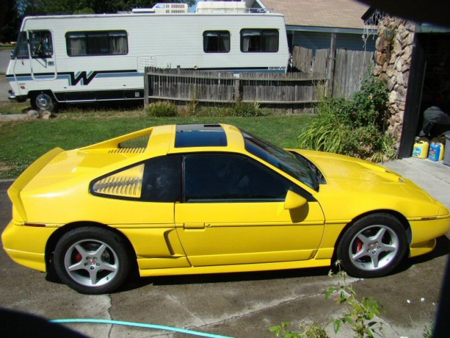

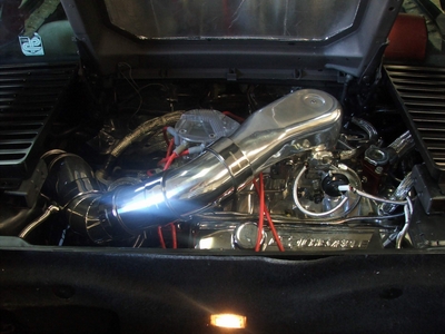

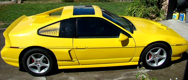

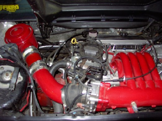

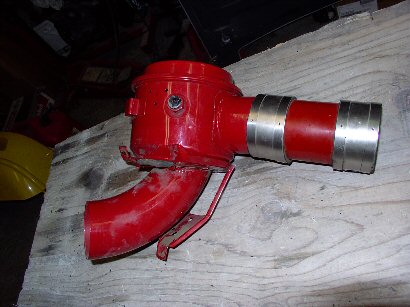

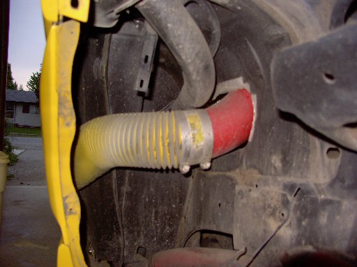

I am using side scoops on my 4.9 They are not Archie's. What I did was to fiberglass a intake tube from a Chevy Blazer to the back of my scoop. I modded my air filter by removing the spider and welding a 3 inch to the bottom of the can it runs into the wheel well and connects to the Blazer intake tube.
This is my car. I have this type scoop on both sides. This side of the car has the Oil Cooler in the scoop, On the other side I have done this.
Modded Air Filter can
and in the wheel well
My 4.9 with it's 3 inch cold air intake.

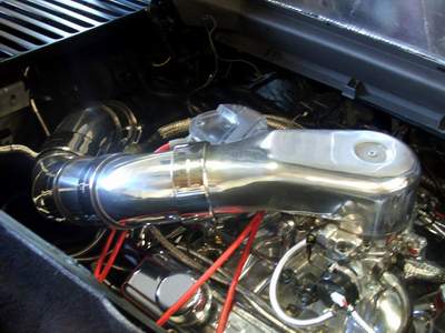

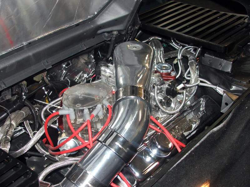

Since I am building a widebody, I use the IMSA widebody fenders but the application is the same as the IMSA quarter panels. I bought a universal cold air intake....just for the parts and tied it to the stock air cleaner. I added dual intake ducts to the body.
Note the opening cut in the rear fender
And the dual duct that I used.

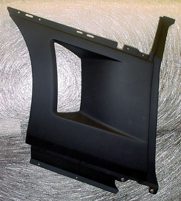

Where could i buy one of those? How did you make the dual intake ducts converge to one tube?
I plan on purchasing these scoops in the near future:
How did you secure your dual ducts to the quarter panels?
