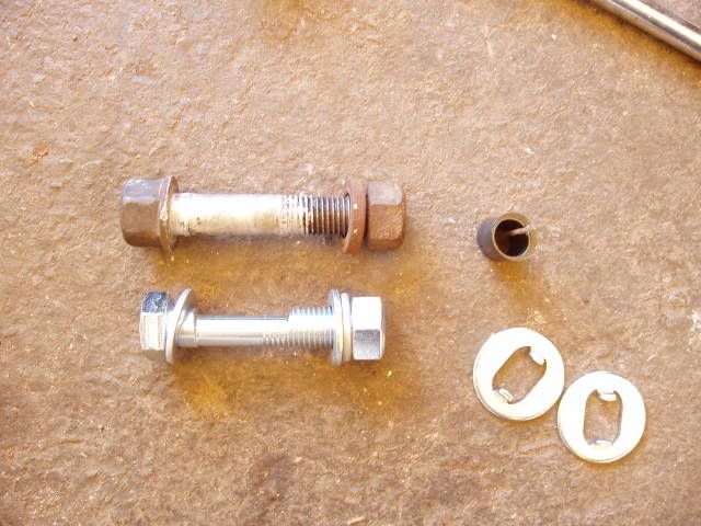

I recently bought tires and had an alignment. The shop is telling me I need cambor and caster bolts $7-8 for bolts and then labor which is unknown at this time. I need a quick answer on my questions so I started a new thread because I think people are not looking at the old thread because they thought everything was resolved. See history here:https://www.fiero.nl/forum/Forum2/HTML/090077.html
Questions: Are they correct in what they are telling me about cambor and caster bolts?
Where are these bolts? Pics if possible.
Should I just do it myself?

Most shops I've been to want to install the offset bolts in order to adjust the rear wheels on the Fiero. It does make doing the allignment a lot simpler.
$7 - $8 for the bolts is reasonable (I've seen shops try to get $20 for them), but the labor might kill you.
They have to break free the old, rusted bottom strut bolts that mount the lower strut bracket to the knuckle. If they haven't been removed in years, they'll eat up a few hours of shop labor time.
If you want to save a few bucks, buy the offset bolts yourself, and PB Blaster the lower strut bolts for awhile. Break them free with a good breaker bar and ratchet, and clean and replace them along with the offset bolts for the wheel allignment. If you do this without disturbing the strut allignment, you can then drive your car to the allignment shop, and all they'll need to do is just do the allignment.
You may find the same problem for the upper front A arm bolts and shims. Rusted tight over the years.
Good luck, hope this helps

For the rear struts, you want the bolts from www.NAPAonline.com - PN NCP2643609
www.rockauto.com has the equivalent Spicer unit PN 6161014
http://www.rockauto.com/cat...52,pgname,Suspension
Moog has a kit as well that slightly different.

I used the NAPA ones on the rear of mine. They worked great. Use the online part number, because it didn't show up on the store computer. Make sure you tell the alignment shop[ that you installed them. And make sure that you tell them that you replaced the balljoints and struts. Some aligners suck big time.

The camber bolts shown above with eccentric washers are for the rear stuts. They will add some additional adjustment because they are smaller than the stock bolts.
The alignment shop should try to adjust rear camber with the stock strut bolts first before selling you the camber bolts with eccentric washers.
you want to use the upper ones shown here
the lower ones have a special sleeve, and are really nifty - BUT - they dont have quite the range of adjustment as the ones with the cam washers.
but - either way - even without cammed bolts - a decent alignment tech should be able to do the job.

I have the Ingalls Fast-Cam bolt on the upper strut mount bolt in the rear. I dont like them very much because you have to pull them out and turn them around to get positive/negative camber correction which requires some mental gymnastics to make sure you're putting it in the right way. I'm still not sure how they even work. The Moog bolts on rockauto listed for the fiero look much more simple to use, and the same for the NAPA bolts.
Does anyone have any experience with the NAPA or Moog bolts that can give a run down on how/how well they work?
IXSLR8
Posts: 674
From: Post Falls, ID, USA
Registered: Sep 2004
Report this Post02-23-2010 03:29 AM Click Here to See the Profile for IXSLR8Send a Private Message to IXSLR8Direct Link to This Post
I have the Napa ones pictured in the post with brand new KYB struts and coil overs. I installed the camber bolts took the car to a anlignment shop and they broke one of the slotted washers washers trying to adjust the rear. They must be very brittle. They said that they wanted more adjustability and told me to diegrind out the holes in the upper strut. So, I took the car home and elongated the holes with a die grinder and put the stock bolts back in. That seems to have done it. Anyway, I'm due to take it back to see how it measures now. Just waiting to get the engine cradle back in the car after a recent clutch changeout.

I mentioned this in another thread. there are a few possibilities why they have this issue.
1. some knuckles have an extra casting flash that does not allow the cam bolts to fully pivot the knuckle in the strut sleeve. Apparently it is not consistent which cars have this issue, tho I thought it was only 88's, I could be wrong on that. (the cam
2. the strut plate cam part is worn down. look where the cam washer rides on the raised stamped part on the sleeve, if it is not square but looks rounded off, then look at the washer and see if the edge is rounded and the washer slightly bent up. if so, that sleeve is shot. new struts should not have this problem unless the mechanic was an animal and forced the adjustment and rounded off the ridge. check the knuckle also for something that is not allowing full travel, ie part 1.

Thanks Fieroeverywhere, what about installing the struts wrong? Is it possible? Do they need to line up any specific way? My shop said my new Monroe struts didn't have enough camber adjustment (see previous post).
Fieroseverywhere
Posts: 4242
From: Gresham, Oregon USA
Registered: Mar 2006
Feedback score:    (14)
Total ratings: 89
Report this Post02-24-2010 10:40 AM Click Here to See the Profile for FieroseverywhereSend a Private Message to FieroseverywhereDirect Link to This Post
The struts can't be installed backwards (won't bolt up right). There is no right and left either. Its very possible that the amount of adjustment from brand to brand could be different. It all comes down to the strut mounting hole and how much it is elongated in your particular car.
It seems odd to me that they could not get better then +1.7 degrees on one side. Thats nearly 3 degrees off what it should be. How much is your car lowered? Camber bolts will help but I would take a good look at the struts and mounting holes in the knuckle to be sure there is nothing blocking full adjustment.
For front caster you will need new washers. On a stock 84-87 fiero there are two 6mm spacers for the upper A arm. Its not recommended you move both to one side as it leaves nothing on the other side. The A arm bushings can then be chewed away during normal movement. The spacers also protect the bushings. Caster kits used to be available that contained one 9mm and one 3mm spacer per side. Using these instead of the two 6mm was suppose to be good for an extra 1 degree of adjustement. I don't think they are available anymore but those specific spacers are not that necissary. You can stack washers to match what you need on either side. Try to keep it to a total of 12mm. More or less then that can effect camber ever so slightly by changing the width of the upper A arm. Within reason it can be adjusted for at the upper balljoint. Hope this makes sense.
My particular car gave me problems with the front caster. I was unable to get enough caster using the 9mm/3mm spacers. My solution was simple. I took the two 6mm spacers from each side, machined 1mm off of 2 of them. I put both on the rear side of the upper A arm bolt (now totalling 11mm). Then I added a 1mm spacer to the front side to protect the bushings. This gave me lots of caster and really helped straight line tracking. The downside was increased steering resistance. The added resistance wasn't a big deal though and well worth it in the long run.
[This message has been edited by Fieroseverywhere (edited 02-24-2010).]

Crazy 4 Red 84
Posts: 40
From: Muskegon, MI
Registered: Nov 2009
Report this Post02-24-2010 04:17 PM Click Here to See the Profile for Crazy 4 Red 84Send a Private Message to Crazy 4 Red 84Direct Link to This Post
I didn't think the strut could go in backwards but I wanted someone else to verify this. My car is not lowered at all, all newly rebuilt close to stock. I agree 3 degrees off is a ton, hence the questions. I will check to see if something is in the way holding it up from moving, the only thing that I can think of is a longer than normal axle. This is an 84 with a 5 speed in it (put in by the previous owner). Are the axles a different lenght between the tranny options? Of course they could be the wrong struts also, I did get them off ebay at a resonable price.
As for the front caster, I get what your laying down. I will have to check measurements and see what will work. As stated it is just barely out of cross camber so not high on the repair list right now, but the information that I needed to make it right in the future.

An Update:
After getting all the info here, manuals and a couple of true mechanics I decided to just get the tires of and take a look. What i found is that the adjusting bolt at the bottom of the knuckle was adjusted all the way in (making it the most positive camber possible @ +1.5 degrees). I was so pissed to find it there, which means that they didn't even look so see if it was adjusted all the way out before they gave up and told me they couldn't align it and something was wrong! So I shoved the strut in tightened the bolt up and scheduled another alignment with. When I scheduled the appointment I spoke to them and told them what I found and they said that they would take care of it without explanation. So last Saturday I dropped it off and picked it up with the expectation of it being right, which was asking to much from them! They asked me if I had the car jacked up when I moved alignment at home and said of course. They went on to explain that they had to jack the car up to get the bolts to move and that they could only get it close. WTF does close mean?? Well they gave it a half a** job and gave me the print out. The left was .2 degrees more negative camber than it should have been and the right was .1 degree less negative camber than what it should have been with the explanation that it was close enough. After learning generally what goes into alignments,understanding each aspect of the suspension parts and what it should be, it amazes me what some shops try to get away! Lazy SOB!! Will .1 and .2 degrees out of alignment ruin my tire? I've been told by my mechanic freind's that it will not, but why didn't they do it right in the first place? All know is that they will never get my business again! Thanks for this thread and those who contributed, I learned alot

Unless everything is severly rusted, when the bolts are loosened on GM struts (most FWD and Fiero rear) will collapse inward or negative at the top of the tire. A competent shop will have an inflatable pillow that slides behind the strut that pushes it out or positive when inflated. Just pump it up until you get the exact degree you wish and tighten. Very quick and simple.
albert

Camber Adjustments?
Rodney dickman sells the bolts as well. Those bolts work pretty good to return to stock alignment easy.
