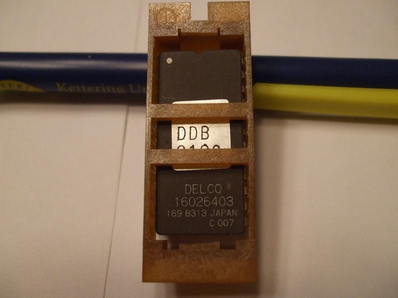

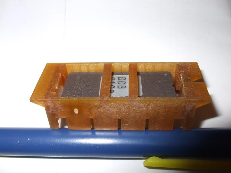

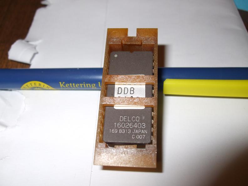

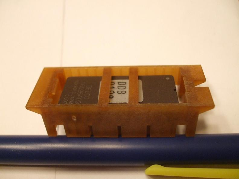

These pics help?
'6156 ECM...
[This message has been edited by KurtAKX (edited 04-01-2010).]
Posts: 41491
Total ratings: 463
Report this Post04-01-2010 11:34 PM Click Here to See the Profile for RaydarSend a Private Message to RaydarDirect Link to This Post
Sorry for the delay.
Mine has the silver sticker, over a slightly raised center section, with a round window.
The full number on the bottom is M2532E/07800.
The sticker reads:
DELCO
DDB
0203
There are some other numbers on the chip, but I don't have a magnifier handy.
