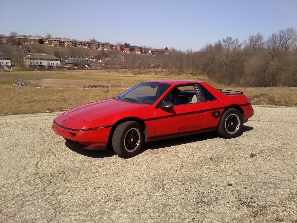

here's my 88 Coupe as it sits in the garage with perfect tire pressure:
205/60R15 15" by 6" Stock 88 GT/Formula wheels - 26 3/4"
215/60R15 15" by 7" Stock 88 GT/Formula wheels - 27 3/4"
