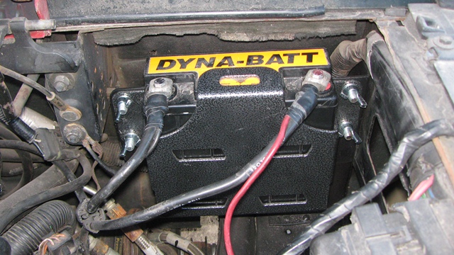

I recently installed a Dyna-Batt dry cell battery into my 1986 GT, rather than relocating the old battery to the front, or dealing with rusty battery trays. I think it turned out quite well, and I have posted a pictures of the install in case some of you decide to go this route as well. The battery itself is about half the size of the stock unit, and only weighs 13 lbs. While I was at it, I also decided to swap the old SI style alternator for a newer CS type. The battery and alternator combo works well.

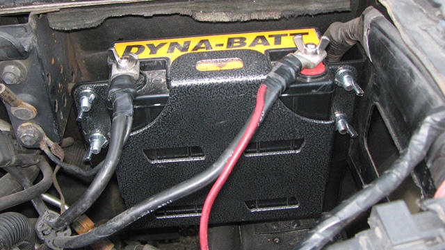

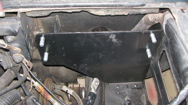

In case anybody decides to mount one of these batteries on the firewall as we did, you will need to keep the part of the old battery tray that is attached to the firewall. The backing plate with studs is welded to the old tab. Next week I'll post some photos of the backing plate and attachment points that we used. Using wing nuts to attach the holder facilitates easy battery removal. Later, I'm planning on using marine style stud terminal adaptors for the battery cables.

Here is a photo of the plate that we fabricated to mount the Dyna-Batt on the firewall, using part of the old tray as an attachment point.
...and the Dyna_Batt installed using wing nuts. Next will be marine style battery studs for the cables.

Picture shows the Dyna-Batt with the 5/16" marine stud terminals installed. Because the battery positive is reversed from the stock battery, the cables are a stretch. New cables will come later, otherwise I'm very happy with the conversion.
