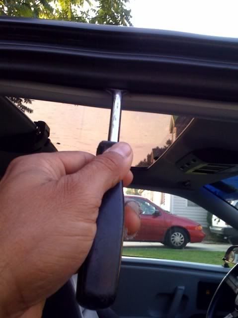

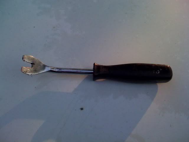

Use a door panel removing tool. Pull down on the a-pillar panel near the roof section. You will see two tabs from the panel. Pry there with the tool working your way from the rear of the panel. Insert tool at the tabs and lift the handle upwards and it will release. The two white ratchet like clips near the windshield will require a pick tool to release te clips. You can use a wire hanger or a long skinny screwdriver.

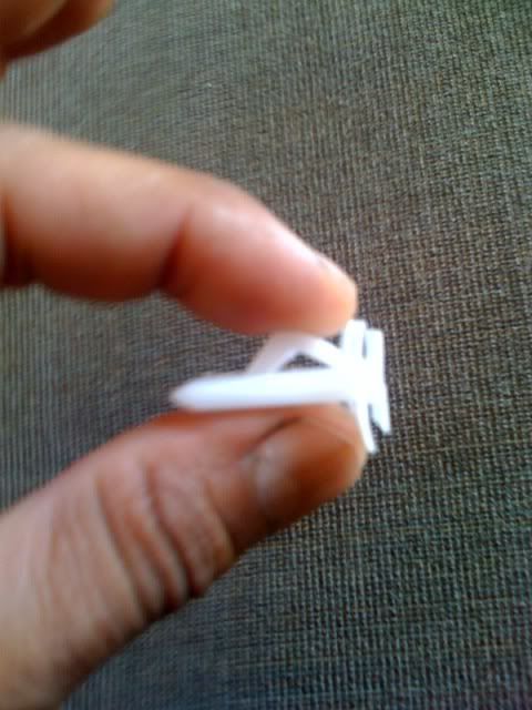

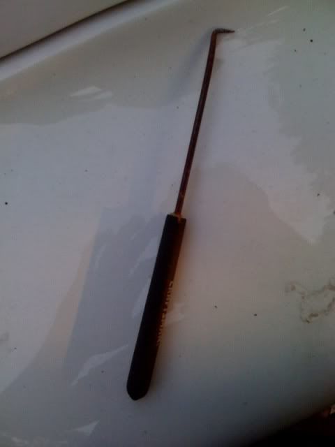

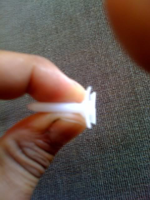

Report this Post02-23-2010 04:45 PM Click Here to See the Profile for Daredevil05Send a Private Message to Daredevil05Direct Link to This Post
Pull the handle upward.
Pick tool.
Door panel removing tool.
A-pillar clips.
Use the pick tool to release the ratchet clips.
