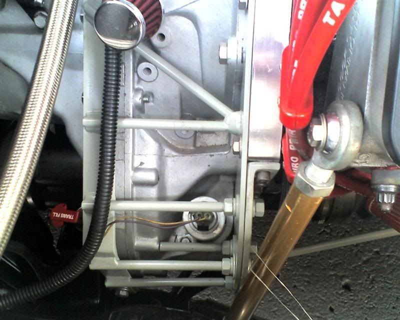

Has anyone experimented with a transaxle girdle similar to ones available for Vettes?
I've seen some failures that look like side loading cause the case to split. This might help with that if there's enough room to get any meaningful bracing on there.
