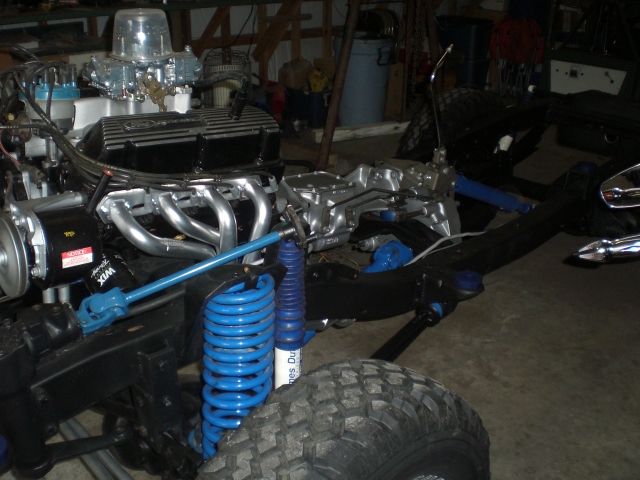

The only sources for the fiero poly bushings I've found are red, have not found any in white or any other color. I know they make poly bushings in different colors as I got some blue ones for my bronco restore. I've also seen yellow ones too but none other than red for the fieros. I may practice on a few with different paints and then rough them up a bit and see how they hold up.

It's not important, just don't have anything red on the vehicle and was just curious. On the early broncos I've restored I could get the bushings in yellow, red, or blue and I couldn't find anything but red for the fiero. Thanks for the info on the black ones though. I didn't think paint would stick to and last but thought I would ask. In light of these comments I'll probably just leave them as is and not worry about it.
