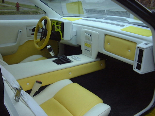

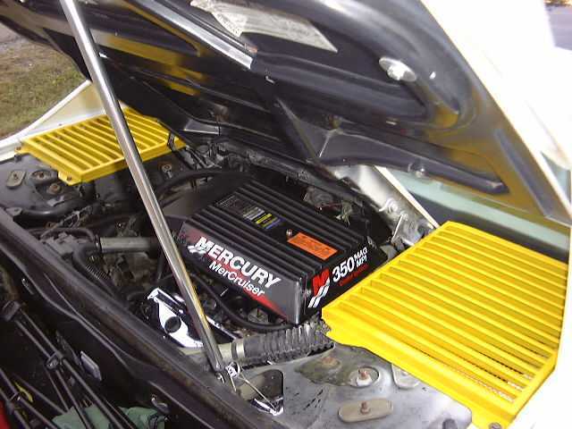

You can search for mercruiser
The yellow and white car at the bottom is Jim Duff's car, out of Illinois. It's powered by a Mercruiser 350. Jim works for Crownline Boats. It's mounted with an Archie kit. Jim is/was a member of Midwest Fieros.
He was a member of this forum at one time. Some jerks gave him grief about the boat theme of his car. Haven't really heard much from him in the last few years.
