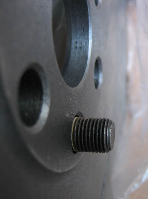

I think maybe I reused the flywheel bolts from when I had the 3.4 in my 5-speed car. I measured them and they are 23mm top to bottom. This is how they look. I think they have plenty of meat to grab.
