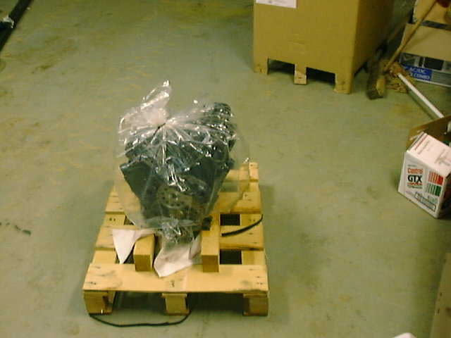

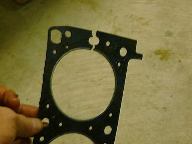

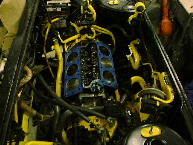

I'm not going to say this is the cause but its hard to explain otherwise: I bought a new 2.8 v6 crate engine for my car. Long block so it already had the new heads installed. I checked the torque on the head bolts before assembly. All good. Assembled & installed engine with a new distributor etc etc... After install, I went to crank it for the first time. BAM!! Big backfire. Had the distributor out 180*. Fixed that and then started the car for the first time. Noticed water shooting out the bottom of head. After scratching my head a bit and a few choice words I disassembled the engine and this is what I found. Don't know what else could have caused this but the big backfire, the engine had never been cranked. Put some new gaskets on and its been fine.
