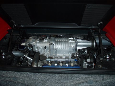

If you want to see what a 3800 SC Series III (Gen five blower) and N* TV looks like installed on top of a ZZP intercooler, here is a picture.

Originally posted by Scoobysruvenge:
What I found interesting was the Ford T-Bird SC it gets fresh air from the top and discharges out of the back
It works opposite to that. The discharge is just the same as the GM. The intake is also just like the GM. They just changed the shape of the inlet/outlet.
