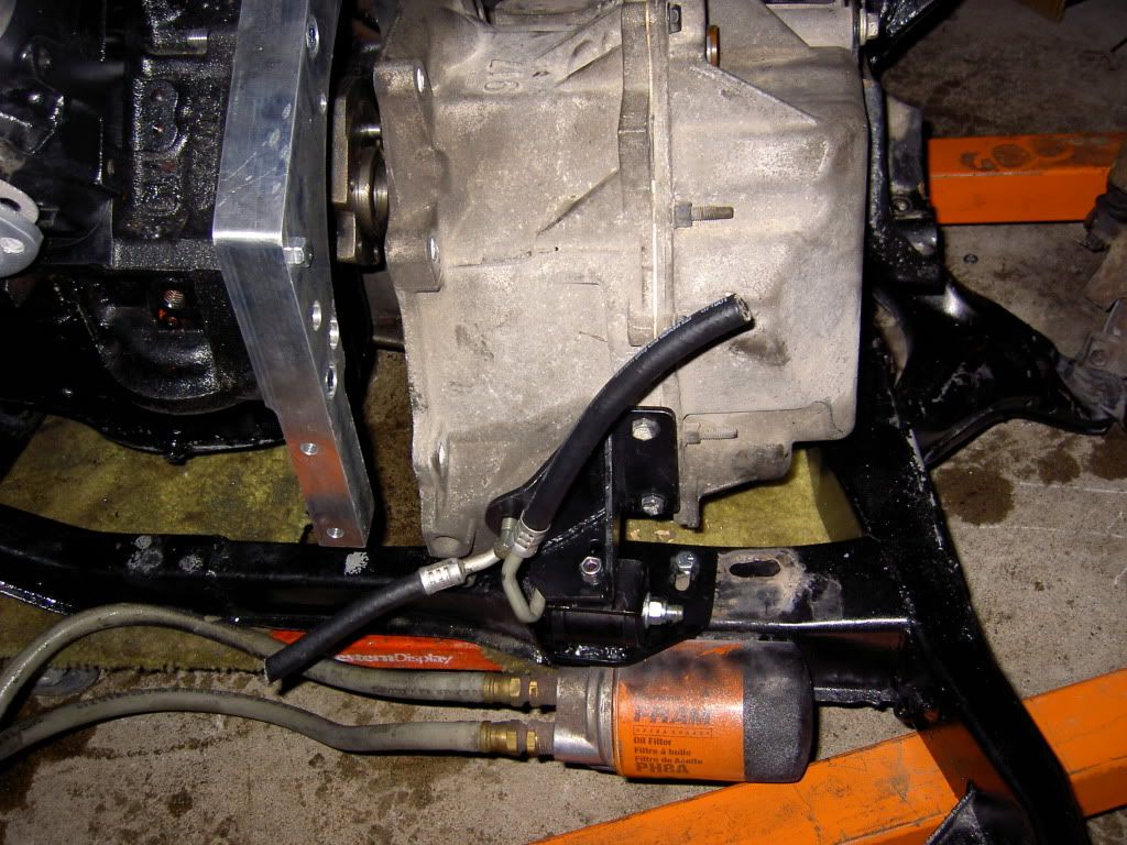

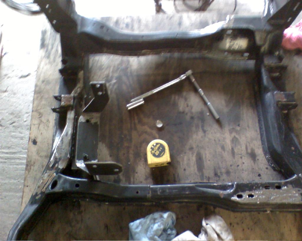

I don't know about the Astro van. But here is one that is off a 95 Pontiac Transport.
Before I cleaned it.
Now this is not my picture. But i did find them on a 93 Regal and they are the ones that I am going to use. They bolt to the Fiero's engine cradle and to the 3800's transmission. Factory parts from the junkyard.

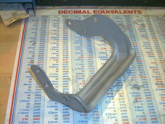

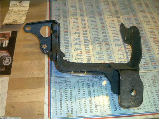

Heres my version of the transport front engine mount on the last build. Front mount on the cradle was removed and a piece of angle was added. Included a pic of the my dawg bone relocation on the current build. The front engine mount is from WCF. Some angle iron and a heim joint it would be easy to add one on the firewall side front or middle of the block depending on your set up. Personal prefererence on trans mounts are rodneys poly and build from there. They're a little pricey but they are good quality.

Originally posted by Dementia:
I used this type of lower dog bone mount style on Norsac's build being the Alt was left up top. I ended up using an 88 lateral link like the 4.9 guys do and it worked out well. I think for manual installs this type of mount is needed no matter what other mounts you use.

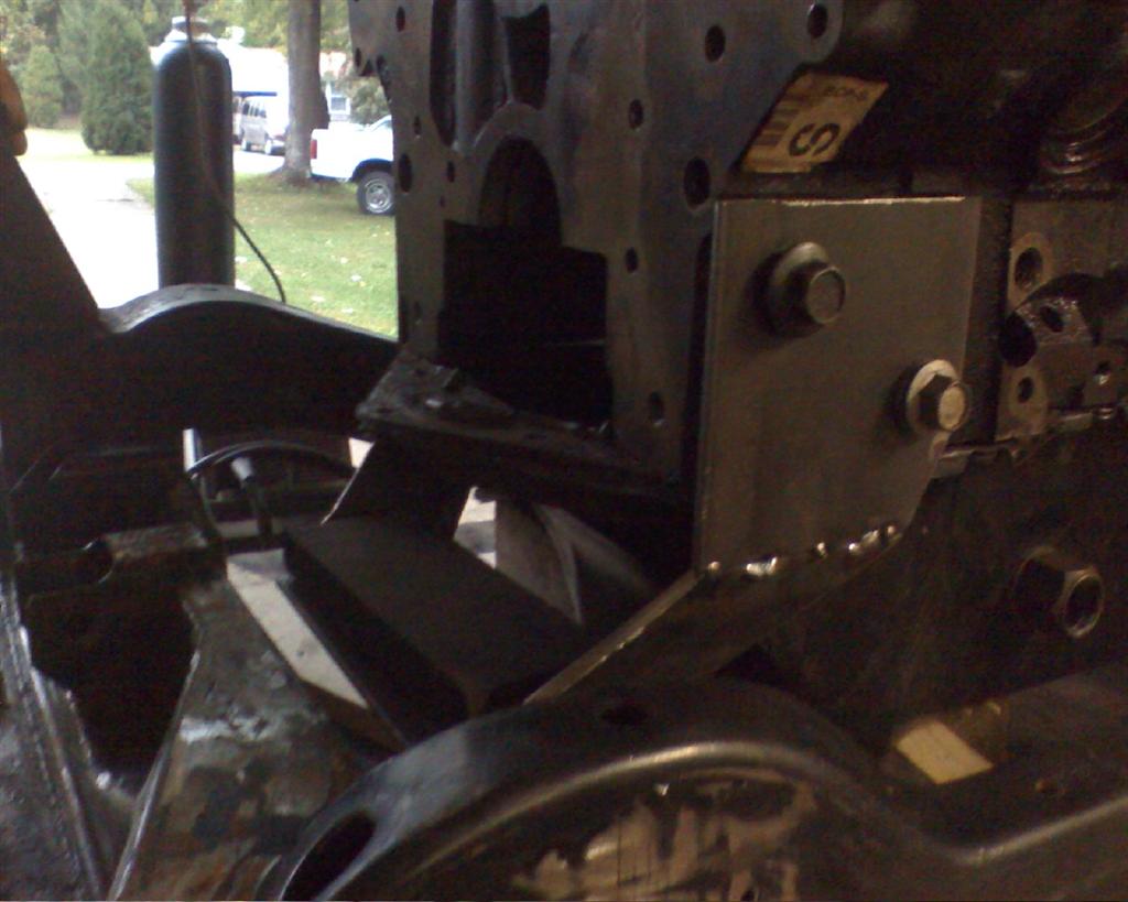

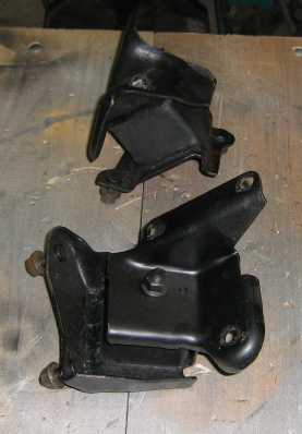

I actually just put the transmission mounts on my 4t65e-hd today. They are the WCF mounts. if someone can tell me how to upload pics, i will upload some.

Report this Post02-13-2010 01:25 AM Click Here to See the Profile for TharimustSend a Private Message to TharimustDirect Link to This Post
Tharimust
88 posts
Member since May 2006
Ok i think i figured out how to post pics.
